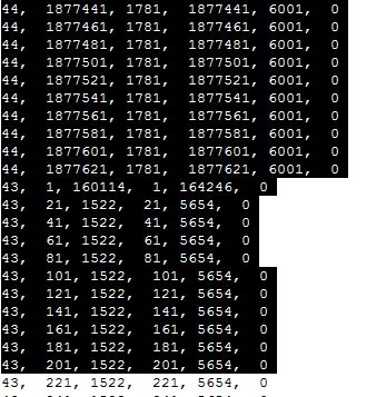

Does _time_diff_xxx() have issues? I get some strange results when .TICKS in the start_tick_ptr is greater than the end_tick_ptr.
I'm trying to measure time between two points, //start time and //end time, then I calc the time with _time_diff_microseconds() at //calc time in the snippet below.
Output is shown below, everything seems OK till the line that starts with "50", then things seem a little strange to me!!
Anyone offer any insight?

DavidS
Hi BillND,
Don't bang the forehead too much ;-)
I just ran my code with IAR6.5.3 and have similar issue:
I will dig into this Monday....off for weekend.

2,640 Views
billnd
Apology time. Really sorry, I've finally opened my eyes to the obvious and realised this is all a big mistake on my part.
The increased time indicated in my original post, where there is a 50 instead of a 43 is caused by the sys tick timer interrupt occurring. Hence the roll over in HW_TICKS value. Blatantly obvious really, but sometime you just can't see the wood for the trees.
Sorry once again, and thanks for your help.
BillND
