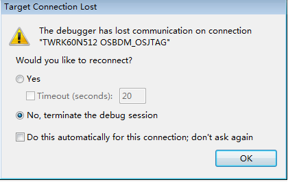

But when I try to debug it, it always gives me lost connection  error.

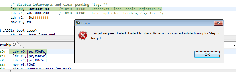

When I try to step in it and find which part cause this problem, at first step(when try to disable interrupt and clear flags), it gives me error:
"Target request failed: Failed to step, An error occurred while trying to Step in target."

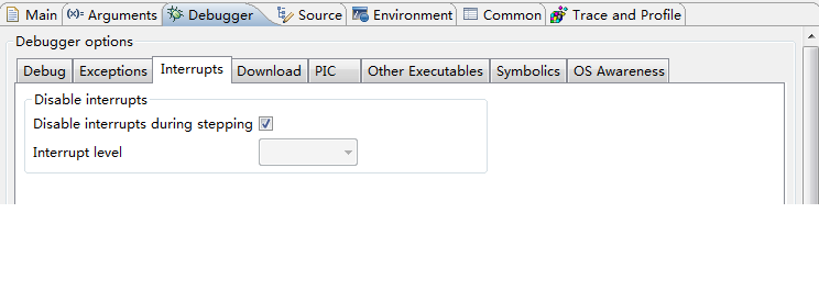

I checked my debugger setting, it is already set to disable interrupt when stepping.

I figure it out. Because the ttya in the library is mapped to PTA1 and PTA2 which are also used for JTAG on my board.
I need to reconfigure the pin for it and it works.
