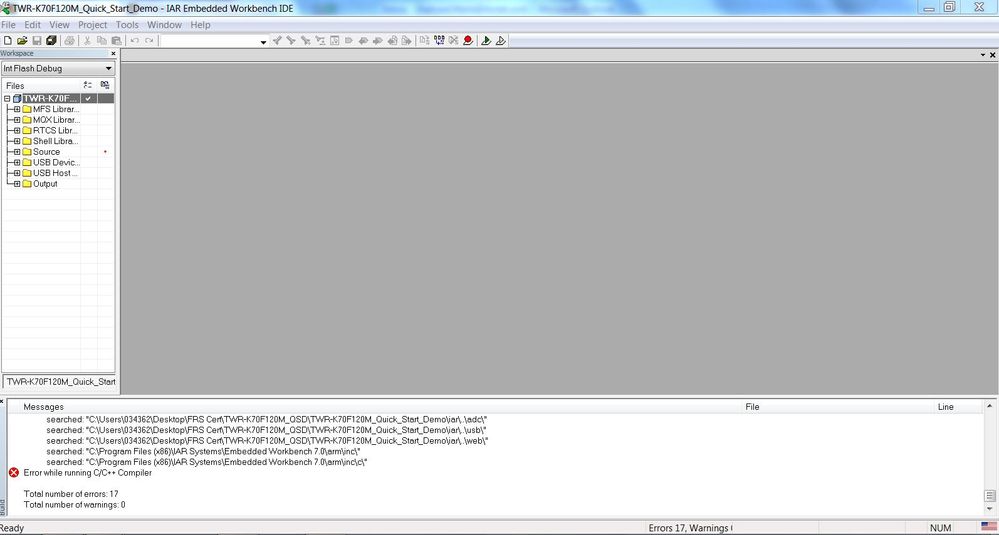

I am trying to get the demo to run back on the Tower K70 board that came on it (Memory Game, SD card reader, Web Interface, acclerometer LED test,  and LED touch)
I am not a software guy at all and I just want to know how to I go about doing this. I have downloaded the TWR-K70F120M_QSD package and read through the quickstart guide.
When this demo was written it was for MQX 3.8 and IAR 6.3. Now I have MQX 4.1 and IAR 7.20

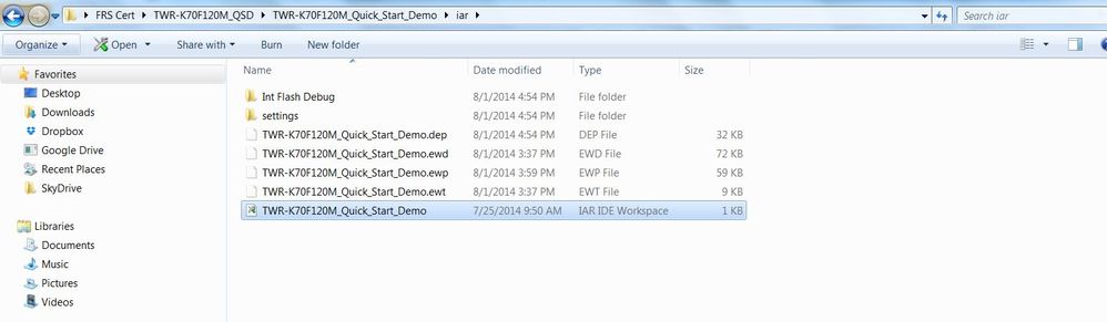

I go to this directory (see below image) and open up TWR-K70120M_Quick_Start_Demo
It then opens up in IAR shown below.I tried to follow the instructions as much as I could but I keep getting error while running C/C++ Complier when I try to debug and download

Quick start demo was written for MQX 3.8, and it is not ported for MQX 4.1 . please see the following thread
demo build problem of TWR-K60N512 Quick Start Demo
