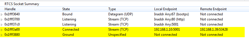

Now i'm using mqx 4_0_2, with cw10.4. When i try to connect with a PC to the tcp socket on a twr-k60f120m with a webserver active the connection works only the half of the time. When i deactivate the embedded webserver it's work great.

UPDATE:
When the connection doesn't work, in the RTCS socket summary i see that my socket is connected and it appear a socket with ground state. When the task work well, the socket in ground state doesn't appear.

Workaround found:
when i wait for activity and my socket is not connected I call the accept() function that block until the connection of a client. Then I wait on RTCS_selectset() to get activity on my target socket. When socket is closed I return on accept() function. If new activity on listen socket is detected i do nothing.

From your description, it seems like accept() creates a new socket OK, but subsequent processing leads to an error. Accept() may return RTCS_SOCKET_ERROR and then you can call RTCS_geterror() on the listening socket to determine the cause. Errors are listed in rtcs_err.h.

I have added somes debug message and I notice that when the connection doesnt work, the task is blocked into the accept(...).
here are the complete code of accept function:
if (mySocket->sock == 0) {   printf("\nAccept new socket\n");   mySocket->sock = accept(mySocket->listenSock, &mySocket->remoteAddr, &mySocket->remoteAddrLen);   printf("\nAccept new socket on: %d\n",mySocket->sock);   if (mySocket->sock == RTCS_SOCKET_ERROR)   {     printf("\naccept() failed, error 0x%lx", RTCS_geterror(mySocket->listenSock));     if (shutdown(mySocket->sock, FLAG_CLOSE_TX) != RTCS_OK)     {       printf("\nfailed shutdown socket (sock == 0)"); //, buf);     }     else     {       printf("\nDISCONNECTED");       mySocket->sock = 0;     }     //continue;   }
  // Send back a quote:   printf("\nCONNECTED"); }
If the client disconnect and connect the task continue to work. Now I try to debug around the task execution.
