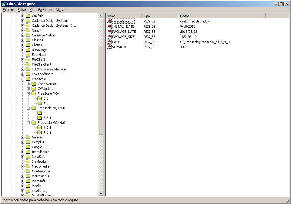

I am using TWRK70 + MQX 4.0.1 + CW10.4 Windows XP + g++ and i am having problems in debugging my Code Cpp and MQX tasks.
In MQX Errors view i can see that TAD Data and Path aren't valid!! How can i define or configure the Path?

Hello Rui Faria,
When the target stops in the debugger, can you use Variable Watch view to show values of _mqx_version and _mqx_vendor variables? If not, this is the reason why TAD cannot derive path to the MQX installation. If the variables are there, then most probably the Windows Registry entries for MQX are invalid. Please check the registry key:
HKEY_LOCAL_MACHINE\SOFTWARE\Freescale\FreeScale MQX\[version]
where [version] are the two MSB bytes of the _mqx_version variable.
The registry key should contain PATH value with the path to MQX installation.

RuiFaria
Hi Martin,
There is the screenshot.
The registry key seems to be okay
