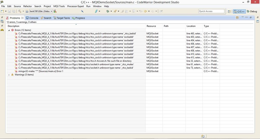

I'm working on a TWRK70 kit, with MQX 4.1. I trying to communicate via socket using mqx. But when I build the project, appears an error at project level, on one of the header used, not at my code.
I will paste here the code and some images.

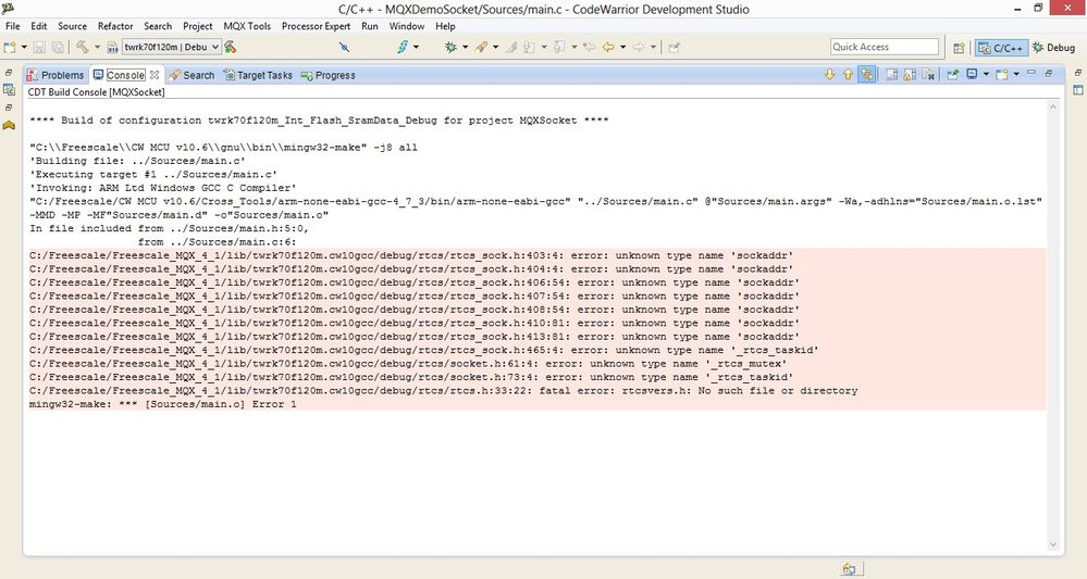

After I build this results appears:
Colud someone help me? Why it is not working?

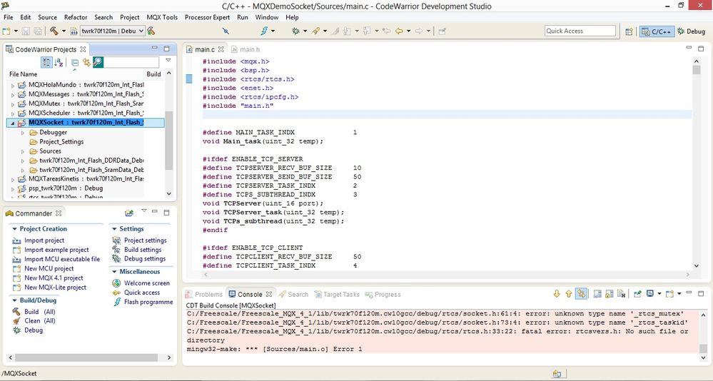

I have taken a look to your code, you should review the way to link the libraries. In my code I have it in this way:
#include <mqx.h>
#include <bsp.h>
#include <lwevent.h>
#include <message.h>
#include <rtcs.h>
Furthermore, I think you should review the input argument of the bind method. It should create at least 1 "child socket". Therefore, it will be
bind(sock_name,1);
Best regards.

juanmanuelpanie
Hi Juan,
About libraries, I have CodeWarrior 10.1 and if I not put like I have (#include <rtcs/rtcs.h>), it no recognized it. Even more, I probe with out rtcs/ (#include <rtcs.h>) and an error appears sayin that the library does not exist.

Carlos_Musich
Hi Juan,
CW10.1 does not support MQX4.1 by default, you may need to make adjustments in the project settings such as source files paths, libraries paths and Windows environment variables. I strongly recommend to use CW10.6.
Do not forget to build MQX libraries (BSP and PSP) and also RTCS library. Make sure your project is including RTCS library in the linker settings of the project. You can take a look to Lab 1 in the post below.
