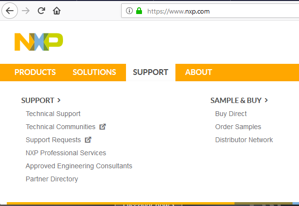

You also can submit a support requests on NXP website if this issue is important and need fast response.
