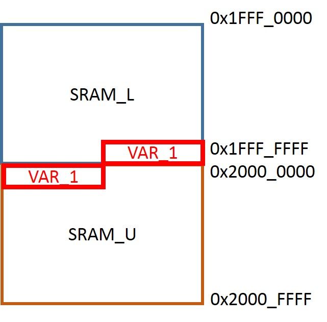

Hello Utsavi,
Let me explain what I think is causing the problem and then you can do next test.
If you remember, SRAM is divided into 2 x 64-kB lenght blocks and they are accessed from different buses so we have to be sure that any object (variable, structure) is not stored by overlapping both sections, for example, next imagen shows a scenario where a 32-bit variable is stored between these blocks:
In this case, there would be an access problem and program would crash. Remember that this could be avoided in compilation-time although it is difficult to prevent this on run-time

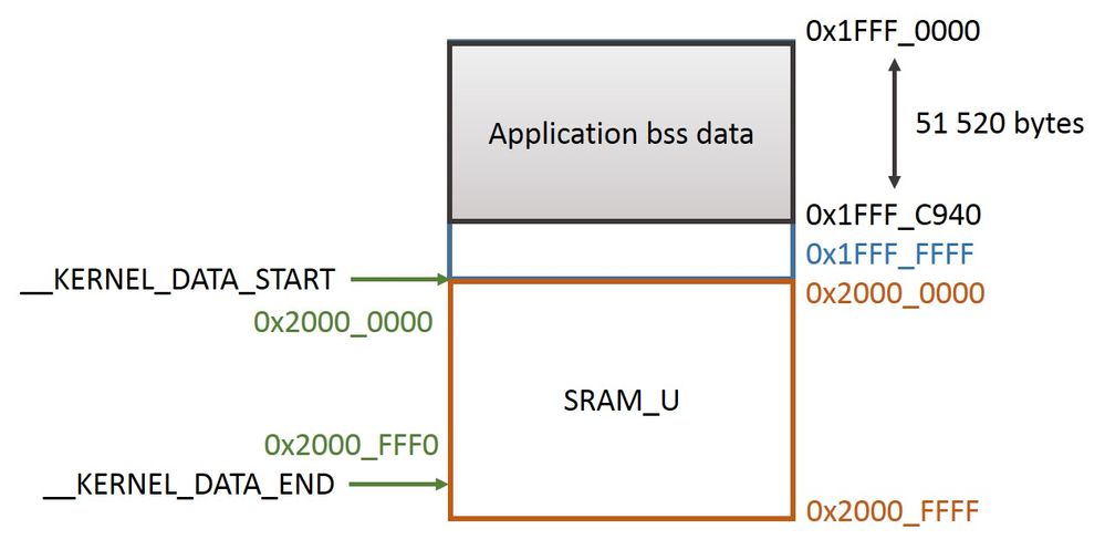

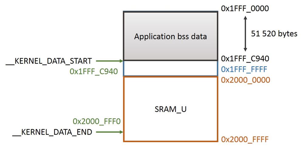

Now, by analyzing your map file, this is how your memory is used:
You application data (like .bss objects) does use 51 520 bytes, after this, there is a segment called __KERNEL_DATA_START that signals where KERNEL will start to use data for stack or heap from different tasks. What i think could be causing the crashing is the fact that kernel could allocate any objetc in the limit of both SRAM sections, so we can make a quick test to validate if this is the problem or you are really using all the RAM in your project.
I'd recommend you to move the __KERNEL_DATA_START address to 0x2000_0000 although the left ~13kB of SRAM_L would get unnused, but this way we can be sure that kernel will not allocate memory in the middle of both sections:

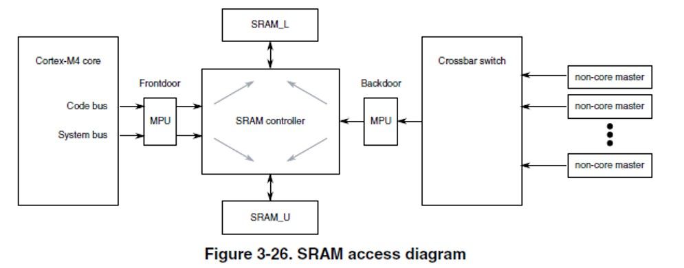

If you look at K60's reference manual in section 3.5.3.2 SRAM Arrays, you will notice that effectively, there are two SRAM sections (SRAM_L and SRAM_U), also, in next chapter, there is a section (3.5.3.4 SRAM accesses) that specifies the access to these regions:
There is a note that says: "Burst-access cannot occur across the 0x2000_0000 boundary that separates the two SRAM arrays. The two arrays should be treated as separate memory ranges for burst accesses".
Problem here is when any object is stored sharing both sections, if this case occurs, we need to modify linker file to allocate a dummy section/variable in this limit to avoid any crashing due SRAM access.
In order to be sure that this is the problem you are facing, could you please be so kind to attach your map file?
