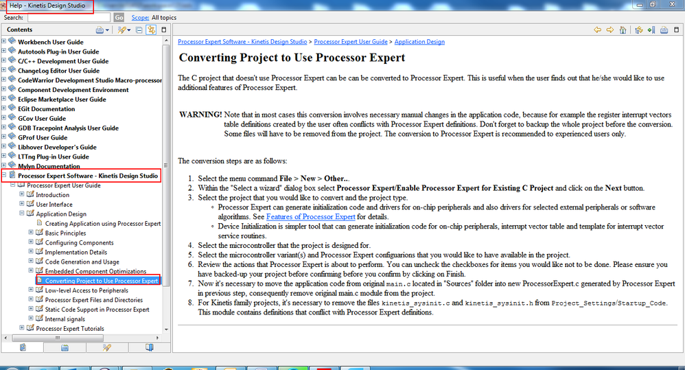

Hi!
I've being successfull compiling some samples for MQX on KDS, however I'm now being happy with PE Demo one.
The software is requiring Processor Expert to be integrated on MQX BSP, and I just can't do that.
This is what I've done:
1. On BSP project, File->New->Other - Processor Expert -> Enable Processor Expert for Existing C Project
2. Selected project and FRDM-K64F processor
3. Generated Code for Processor Expert
4. Deleted Startup code and main.c code
5. Got error when compiling BSP:
..\..\..\..\..\..\KDS_1.1.1\eclipse\ProcessorExpert\lib\Kinetis\pdd2\MK64FN1M0LQ12\system\CPU_Init.h:102:32: error: unknown type name 'LDD_TClockConfiguration'
..\..\..\..\..\..\KDS_1.1.1\eclipse\ProcessorExpert\lib\Kinetis\pdd2\MK64FN1M0LQ12\system\CPU_Init.c:87:39: error: unknown type name 'LDD_TClockConfiguration'
I've tried already to include PE_Types.h unsuccessfully.
Am I doing it right? Any mistake? Maybe this is not the right way to add PE to MQX BSP!
Thank you very much!

Hello Fernando,
You can refer to this as below  :
Hope it helps
Alice

Thank you Alice, but this tutorial holds only on bare metal projects .. for BSP it is not that simple, unfortunately =(
I'm still trying to make things work as I had on CodeWarrior 10.6 (MQX BSP+Processor Expert without KSDK), however already thinking on giving up until this is officially supported on KDS. I'm not sure however if this is on Freescale's roadmap.
Luiz Fernando
