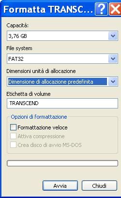

Good morning,
I started from the Freescale example and then I wrote my application.
The USB key, which I used, is a Trascend 4GB formatted by Windows XP as you see in attached picture.
With the USB key Titanedi 4GB I had another problem: often after some seconds the software give me the signal of detached key even if the electrical contact, that supply voltage, and the electric signals are all good.
I got these problems, when I wrote a new file of 4096 pages  of 257 bytes writing a page at time.
It seems that I not have these problems, if I write the same files but writing 1024 pages of 257 bytes at time.
Do you know the why? Is it more sure a less number of accesses of USB key?
Thank you.

Hi Mirko,
Are you using your custom board and/or custom project/application? Have you testes using the MSD_USB example
located on the following path of the MQX installation directory:
    C:\Freescale\Freescale_MQX_4_0\mfs\examples\mfs_usb\
I just tested this example using CodeWarrior v10.4 and TWR-MCF5225X + TWR-SER using many USB sticks formatted on FAT and FAT32 formats, and I didn’t get that error.
According with “Freescale MQX MFS User’s Guide” document, the FS_SECTOR_NOT_FOUND error is returned from the device, over which MFS is installed, when an error occurred while writing to the disk, maybe because the drive was formatted with incorrect parameters, or the partition table specified incorrect values. Additionally, have you also tried with a different USB stick?
Hope this will be useful for you.
