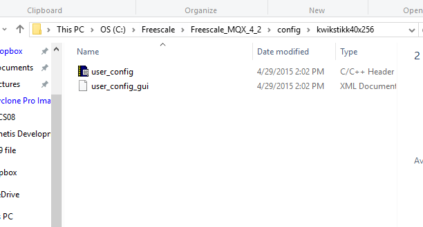

Hi, I am getting started with the Kinetis K40 using K40 KwikStik.
However,  I already facing some problem getting started.
In Chapter 5 of the AN4523 step 4 'Find the MQX build libraries workspace directory located in: MQX_DIR\config\kwikstikk40x256\uv4\", I am unable to find 'build_libs.uvmpw' which is required by step 5 'Open the MQX “build_libs” project (file: “build_libs.uvmpw”) “bsp_kwikstikk40x256 Debug” has to be selected as active target -Figure 4.'
I have downloaded & installed latest MQX 4.2.0.
This is what I have in my folder.
Also is there anyway to plot the same code to Freescale KDS? or any similar example on KDS?
Please advise.
Thanks.

Hello MY
In MQX 4.2, this working set (“build_libs.uvmpw” for UV4 or “build_libs.wsd” for CW) does not exist anymore, it is only available for MQX 4.0. In MQX 4.2, you should import every library (bsp, psp, mfs, shell, etc) individually.
I have migrated AN4523 SW for MQX 4.2 and created a new project (it is attached) but this was made for CodeWarrior however, it shouldn't be difficult to migrate it to KDS.
I hope this can help you.
If you have another doubt please let me know it.
Isaac
