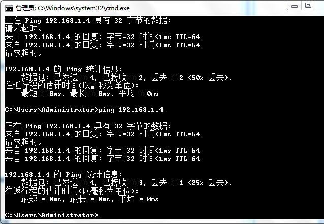

After porting the MQX3.7 to  K60MK60DN512ZVLQ10 ,I "PING" to MCU and find that:
1 when connecting K60 to PC in OFFICE ,"PING" is OK ,even UDP is OK .
2 Then bing a switchboard between them,"PING" is not stable, often come to a timeout.
3 connect two PC each at home ,PING is not stable,often come to a timeout.That's impenetrable~
I have explored this issue for 2 days,and still can't work out.
Key CODE shows below:
#define ENET_IPADDR IPADDR(192,168,1,4)
#define ENET_MASKADDR IPADDR(255,255,255,0)
#define ENET_GATEWAYADDR IPADDR(192,168,1,1)
#define DEMOCFG_DEFAULT_DEVICE BSP_DEFAULT_ENET_DEVICE

phy ship is KSZ4041

Hi Yong

sry for delayed reply ,my lovely boy is just 36 days old .I have little time to open my PC these days。。
I use a custom board, all the pins of 8041 ship on board are confirmed according to the PCB. CLOCK  frequency is changed based on the board 50Mhz.
I thought it should be easy to porting MQX on my board since the default PHY ship is kzs8041 in MQX 3.7.However....
Is it possible  if I ignored something that need to be changed ?

Since ping is OK at office and timeout at home, I would suggest check if there is IP address conflict, or MAC address conflict?
