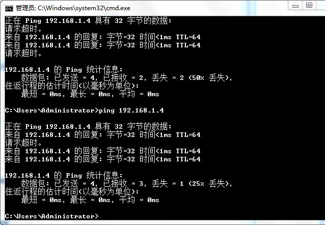

After porting the MQX3.7 to  K60MK60DN512ZVLQ10 ,I "PING" to MCU and find that:
1 when connecting K60 to PC in OFFICE ,"PING" is OK ,even UDP is OK .
2 Then bing a switchboard between them,"PING" is not stable, often come to a timeout.
3 connect two PC each at home ,PING is not stable,often come to a timeout.That's impenetrable~
I have explored this issue for 2 days,and still can't work out.

Hi Yong
Which board you are using, TWR-K60N512 or TWR-K60D100M board, or custom board?
2,377 Views
tim4146
sry for delayed reply ,my lovely boy is just 36 days old .I have little time to open my PC these days。。
I use a custom board, all the pins of 8041 ship on board are confirmed according to the PCB. CLOCK  frequency is changed based on the board 50Mhz.
I thought it should be easy to porting MQX on my board since the default PHY ship is kzs8041 in MQX 3.7.However....
Is it possible  if I ignored something that need to be changed ?
THX for your help very much!
2,377 Views
danielchen
Congratulations, Yong! Wish your baby a healthy and happy life:)
Since ping is OK at office and timeout at home, I would suggest check if there is IP address conflict, or MAC address conflict?
