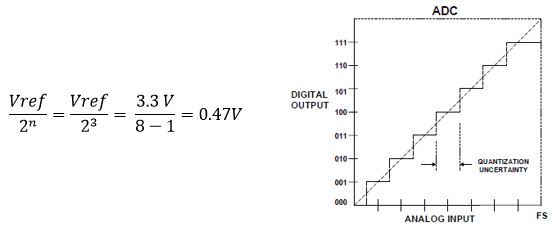

5. As an example, if the ADC resolution is 3, the Less Significant Bit is set as follow:
Based on the figure, depends of the analog input, there is a corresponding digital output.
