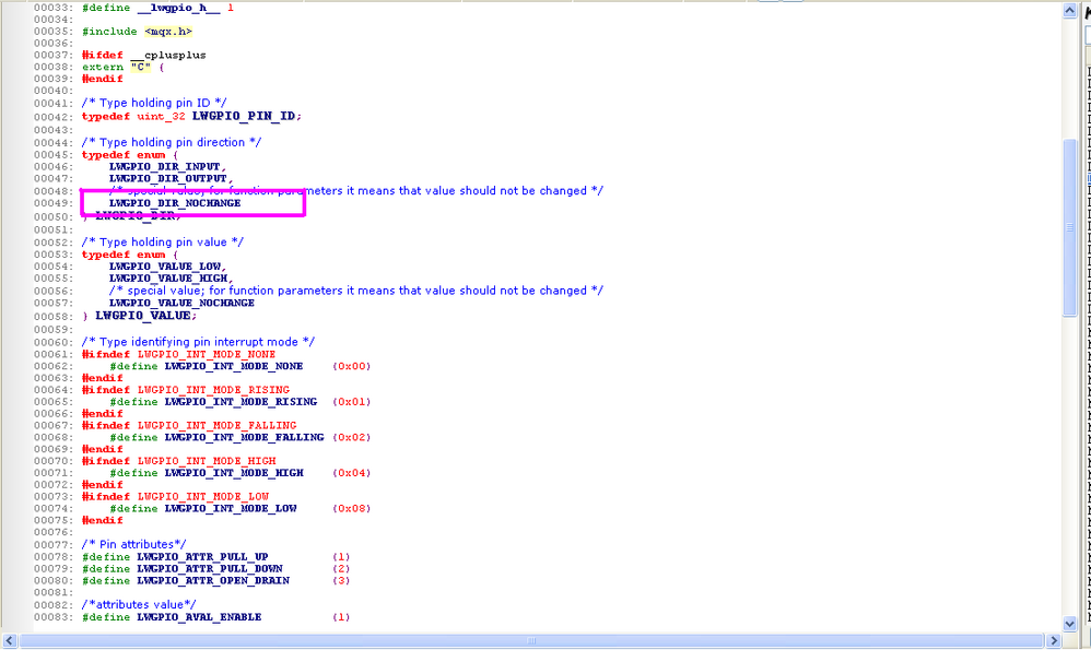

I'm using MQX4.0 to work my touch panel, but i stock at the define LWGPIO_DIR_NOCHANGE !
I wanna know whether this define same as defining PIN to the open drain mode or not?
please help me on this problem!
best regard
victor

Hi Victor:
No, it is not open drain mode. Just means that this value should not be changed. Please refer to the implementation of LWGPIO_DIR_NOCHANGE.
void lwgpio_set_direction
    /* Pin handle to set direction on */
    LWGPIO_STRUCT_PTR  handle,
    /* Direction to be set */
    LWGPIO_DIR         dir
    if (dir == LWGPIO_DIR_INPUT) {
        handle->gpio_ptr->PDDR &= ~handle->pinmask;
        handle->flags |= LWGPIO_DIR_MASK; /* mark the pin is input */
    else if (dir == LWGPIO_DIR_OUTPUT) {
        handle->gpio_ptr->PDDR |= handle->pinmask;
        handle->flags &= ~LWGPIO_DIR_MASK; /* mark the pin is output */
    else { /* LWGPIO_DIR_NOCHANGE or other value */
