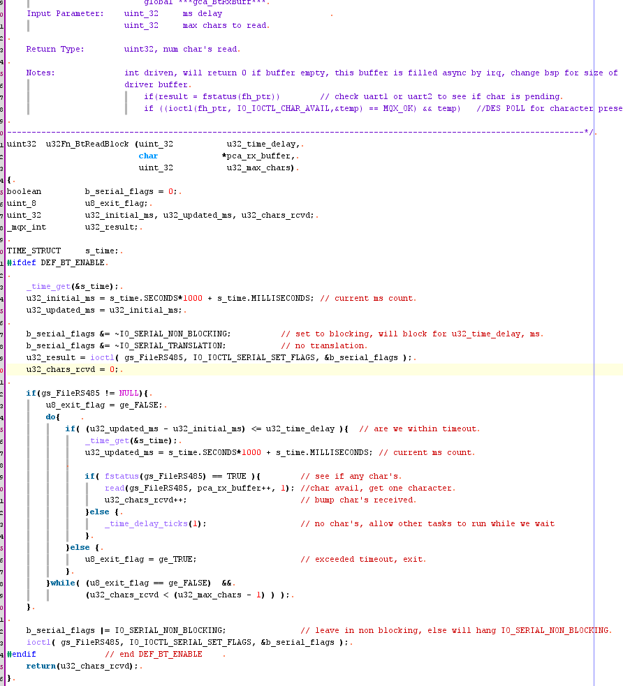

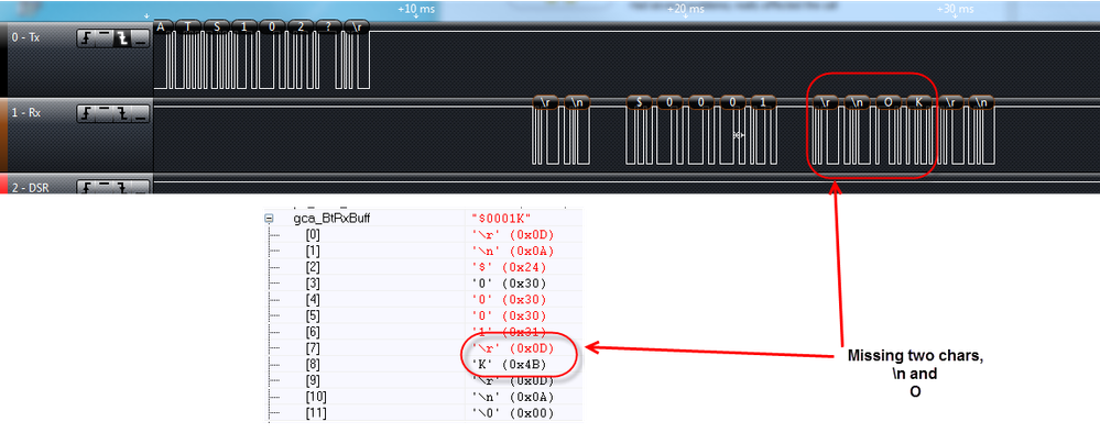

I have read through the posts on this for the blocking and non blocking modes of the serial driver and it seems to me that some of the char's are being translated. I tried clearing the flags as in the code inserted but it doesn't do any good. You can see from the logic analyzer that we are receiving a specific stream, but from the snapshot of the debugger variable buffer we are missing some char's. We don't always get the same char missing, sometimes it is the '\r', other times it is the '\n', we are consistently missing the "O" in OK. The code implements a timeout check and number of char's expected check, these work correctly. We also check the status on the ioctl settings with the debugger and this yields success. Is there an error in expecting no translation of the char's in blocking mode, when we clear the IO_SERIAL_TRANSLATION flag?
Any advice would be appreciated. Thanks.
Robert

Here is the entire code segment. The pca_rx_buffer is a pointer to the char array which is passed to this function.code 2.png
Robert

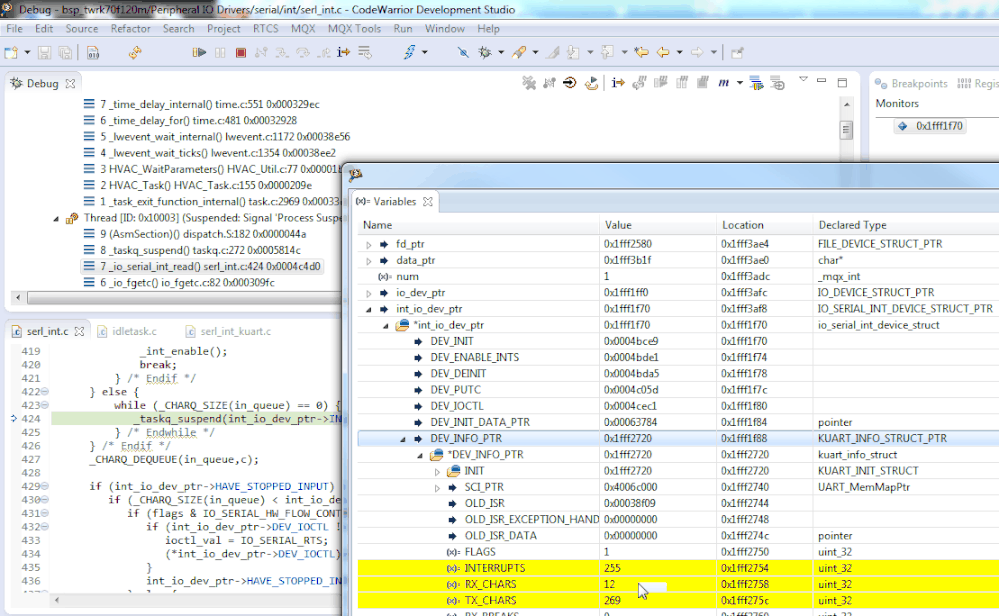

After you send your stream of characters can you break and look at your serial task and see how many interrupts were processed?  Hopefully it is the same number as characters you send.
That might help to see if the translation stuff is messing up someplace and help to determine if the characters were seen in the interrupt at least.
Here is a picture of my serial task with Variable window opened on the int_io_dev_ptr.  Note I had to re-cast the DEV_INFO_PTR to "KUART_INFO_STRUCT_PTR" to look at the RX_CHARS variable that is incremented each time a receive serial interrupt occurs.
David

brianpaterson
Hmmm....
After some trial and error, it seems that the delay time may be biting you.
OK, some basic stuff:
Characters are transmitted generally in a stream and generally at whatever baud rate and generally contiguous.
Cool. But note the "generally".
However, there is slop in the system. This is where the transmitting device pauses, ever so slightly, and then resumes (CPU gets an interrupt for example).
Well the CPU may not pause and transmit faster than you think. So the delay time is now skipping too far into the future.
I would try a shorter delay (much shorter) or buffer more characters in the incoming device.
You seem to be skipping characters on the leading edge of the transmission, correct?
At least, I did when I coded in your routine.
Thoughts?
Robert
