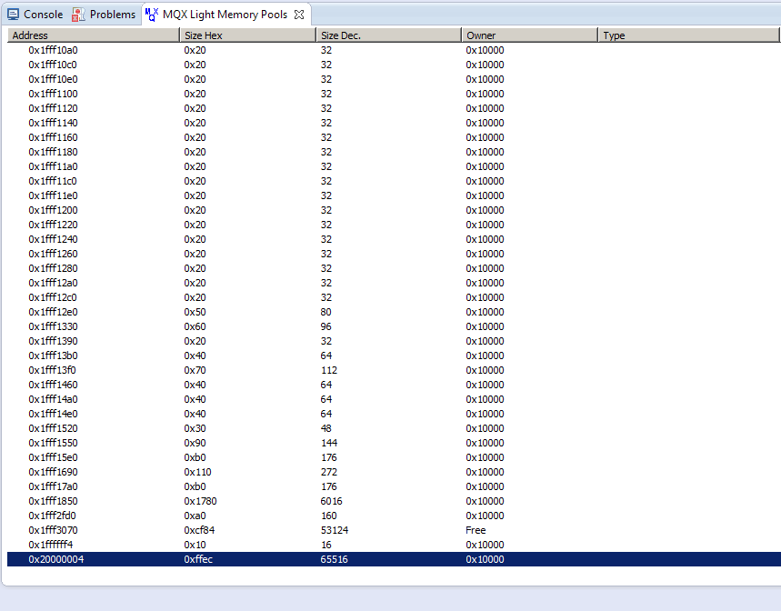

Hi all,
i am pretty new to MQX and i have question about memory usage. I have successfully ported a K60 MQX BSP to MK20DN512VLK10 MCU on our custom board. I ran into a problem when i wanted to reserve a large memory pool (64 kB) in internal RAM. I get an out of memory error in this case so i looked into a memory usage in CodeWarrior debugger:
Despite i have a very simple application with two tasks using approx. 5 kB of stack there is complete upper part of internal RAM occupied and unavailable (highlighted). Is that something to have to do with the fact, that internal RAM memory on our MCU is split to SRAM_L and SRAM_U? Am i missing something in linker script?
I also tried to run some example applications found in MQX folder but there is no change in usage of upper part of SRAM. I don't believe that MQX kernel and heap should use that much memory in this case...
Any advice would be appreciated.

HI all,
i managed to get this memory free, it seems that there were some remains of RTCS when porting from K60 to K20. Now i have another problem.
Internal RAM (128 kB) on our K20 MCU  is organized in two parts: SRAM_L and SRAM_H. Each part has size 64 kB. There is a boundary address betweeh those two parts at 0x20000000. This memory boundary shouldn't be crossed in single instruction.
I need to allocate 64 kB of RAM in our application. This is exactly half of our RAM or exactly one part if it. Even though i have plenty of RAM free now (more than 117 kB) i cannot allocate 64 kB of RAM from address 0x20000000 on (i get out of memory error). I took a look into linker script and noticed, that there is MQX kernel data and MQX heap allocated at:

Problem is that i "see" only 64 kB of RAM (only SRAM_L) if i check memory pool with the debuger tool in CodeWarrior. I get an out of memory error if i try to allocate memory in this case. I also tried do allocate another memory pool with _mem_create_pool command but my application ends with error in "dispatch.s".
Is there a way to modify linker script that everything is being kept in SRAM_L and i have complete SRAM_H avalilable for my application data?
