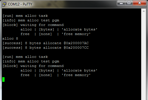

Now when you allocate memory by using OSA_MemAlloc()method from fsl_os_abstraction, your pointer should return a 32 bits address.
I did some test with 2x8bytes memory allocation. The address show below correspond to my two address pointers after OSA_MemAlloc()
Even OSA_FreeMem()work also very well.

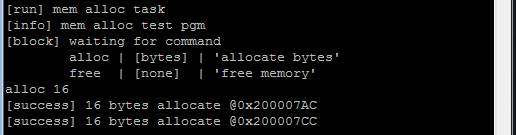

The only thing that I don't understand yet is why an allocation of 8 bytes have the same address gap than 16 bytes ? See below :
Even worst, if allocate just 1 byte, the gap between two allocations will be 16 address ... Does the MCU will lost these memory space ?
