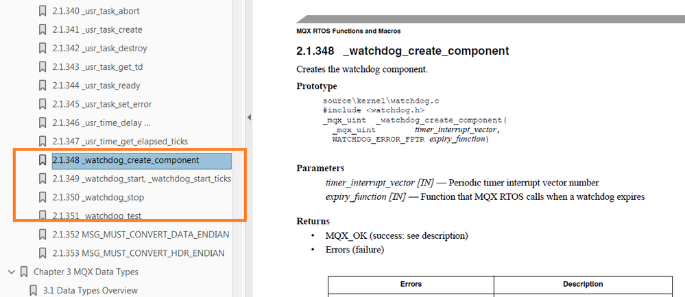

I am using TWRK64 board with MQX4.2 on KDS V3. I was looking into the watchdog example(the only reference for MQX Watchdog I could come across!). The _watchdog_XXX APIs are poorly documented and there is no clarity on the usage of these apis.
I'ld appreciate if any usage and examples are shared.

Hi CSMG Sarma
Please refer to the MQX Reference Manual in the MQX installation folder, section 2.1.138--2.1.351 describers the _watchdog_xxx API.
Please also refer to the watchdog demo
Freescale_MQX_4_2\mqx\examples\watchdog

Hi danielchen@fsl‌
I had figured it out. Didn't close the request.  Implementation includes a K64 system reset as watchdog ISR. It is as follows:
* \brief initializes the MQX watchdog timer and runs it for ever. Created by Main_task.
* @param initial_data task data. Usually NULL
void wdt_task(uint32_t initial_data)
        MQX_TICK_STRUCT ticks;
        _mqx_uint       result;
        _mqx_uint       n;
        result = _watchdog_create_component(BSP_TIMER_INTERRUPT_VECTOR,
           system_reset);
        if (result != MQX_OK)
           printf("\nError creating watchdog component.");
           _task_block();
        else
             printf("Watchdog created successfully\n");
        while (TRUE)
           result = _watchdog_start(WATCHDOG_SLEEP_TIME + 10);//!to address the context switch delays a short 10ms delay added.
           _time_delay(WATCHDOG_SLEEP_TIME);
           _watchdog_stop();
* \brief Resets the K64 microcontroller. This is also the watchdog ISR handler
* \note this doesn't check to stop tasks but directly resets the K64 micro.
* @see <a href="https://community.nxp.com/thread/99740">MQX Community</a>
* @see <a href="https://mcuoneclipse.com/2015/07/01/how-to-reset-an-arm-cortex-m-with-software/">MCU on Eclipse</a>
void system_reset(void * ptr)
     (void)ptr;
//     SCB->AIRCR = 0x05FA0002;
//     SCB_AIRCR_REG() =
#if KIN1_IS_USING_KINETIS_SDK
     SCB->AIRCR = (0x5FA<<SCB_AIRCR_VECTKEY_Pos)|SCB_AIRCR_SYSRESETREQ_Msk;
#else
     SCB_AIRCR = SCB_AIRCR_VECTKEY(0x5FA) | SCB_AIRCR_SYSRESETREQ_MASK;
#endif
     while(1)
Sarma
