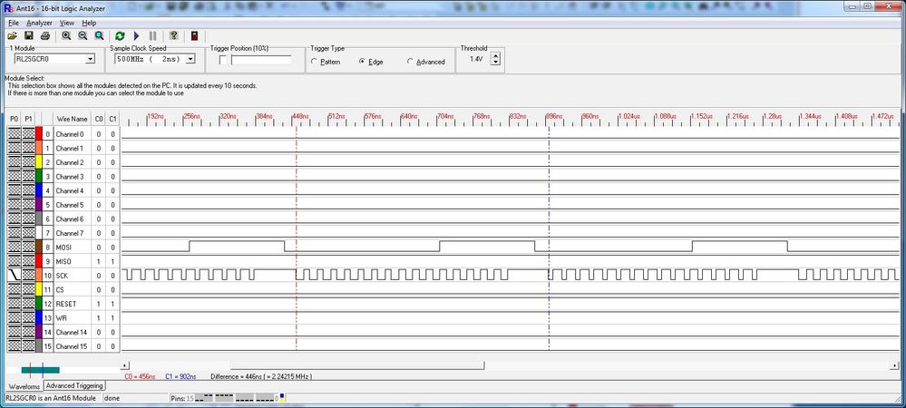

pato3
Related to your 2nd question: for reference I get 446ns (41.5MHz SCK) for a 16bits transfer using bare-metal drivers (SPI1 + eDMA) with CS controlled directly from the drivers (see attached screenshot). TFT 320x240 is completely filled up in 34.12ms.
Same performances for A5 & M4.

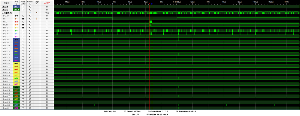

pbanta
Here is a data point.  I've been trying to get the MQX 4.1 DSPI driver working with DMA as I convert a project from MQX 3.8.1 to MQX 4.1 on a Kinetis K70.  I'm seeing huge latency between CS and SCLK on both sides of the transaction.  In this case I'm not using the CS callback -- I'm letting the driver handle the CS.  The actual data transfer is about the same but the total transaction time is very large with the MQX 4.1 driver compared to the driver in MQX 3.8.1.  Look at the chip select line in the screen shot below. 81.65us.  For comparison, the total transaction time for MQX 3.8.1's SPI driver is about 37us.
