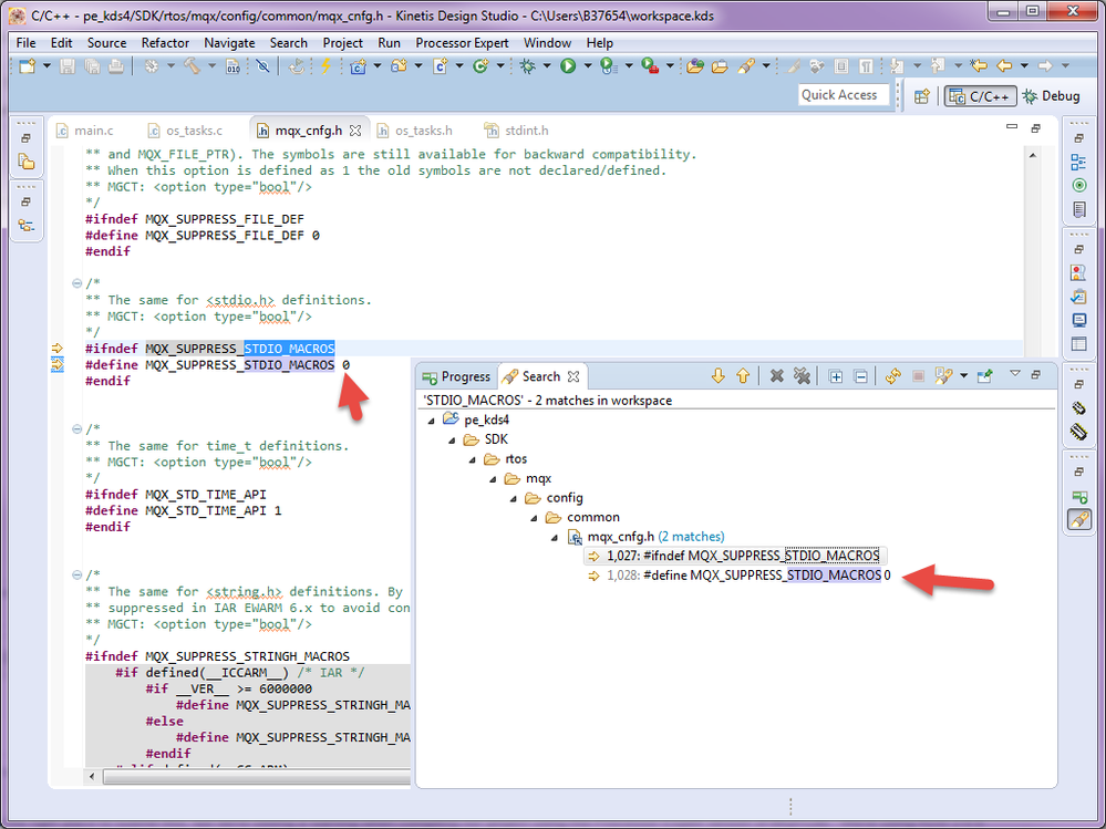

I'm not sure if this is the right place to submit this, but we're seeing a warning when compiling our project using the Processor Expert version of MQX-Lite.  We're using KDS 3.0.0 and have kernel logging enabled.  When it's built, it shows these warnings in klog.c:
implicit declaration of function 'printf' - line 345
incompatible implicit declaration of built-in function 'printf' -line 345
incompatible implicit declaration of built-in-function 'printf' - line 636

Hello David,
These warnings are related to missing definition of “stdin” and “stdout”. Please verify you have MQX_SUPPRESS_STDIO_MACROS = 0
Please let me know if this helps!!
