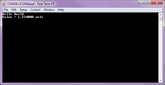

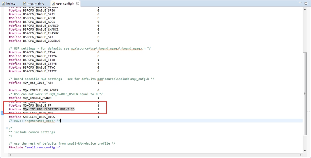

In addition to David's answer, I tested the Hello example  (MQX 4.2 and KDS) with the following modification and it is working.
Could you please test using MQX 4.2??
void hello_task
uint32_t initial_data
        float val = 1.234;
(void)initial_data; /* disable 'unused variable' warning */
printf("Hello World\n");
printf("Value = %f unit\n", val);
_task_block();
Sol
