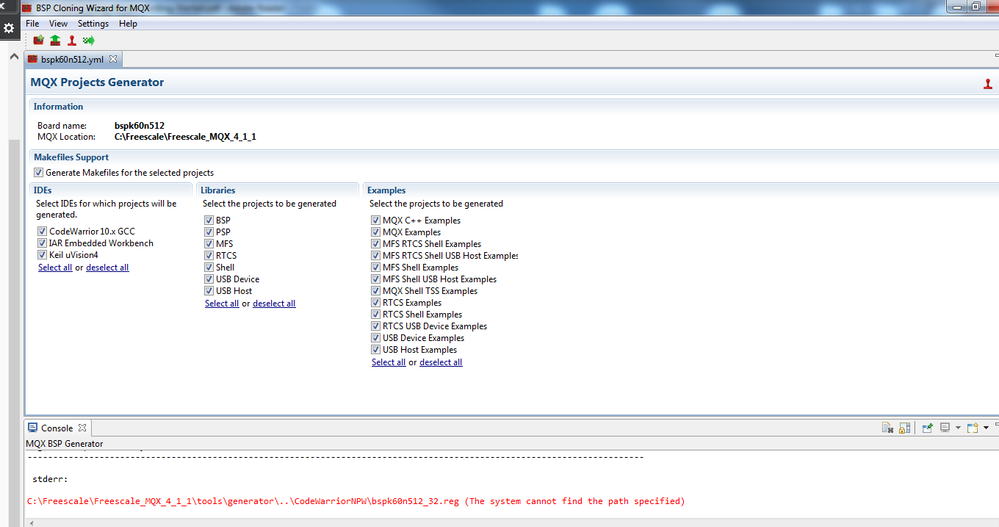

hello
I tried cloning a BSP refer to the "MQX-BSP-Cloning-Wizard-Gettiing-Stasrt.pdf"  and I keep always receiving console error messages
when the application tries to Generate MQX Projects (so no proper  cloning done).
The error messages starts with:

Unfortunately we were not able reproduce it.
Could you please post here whole log (files you can attach in advanced editor – right upper corner of reply window)?
Did you apply bug fix for (globals_full.yml not found)?
https://community.freescale.com/message/431155
Any other changes?

I ran into the same problem.
The renaming of the globals.yml to globals_full.yml should fix it.
Let us know if it does.

Yes !
