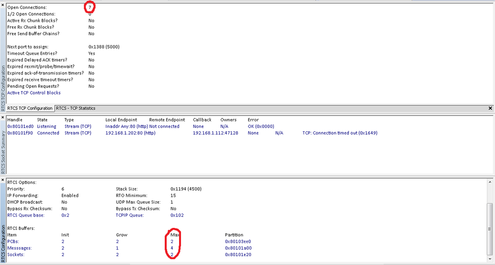

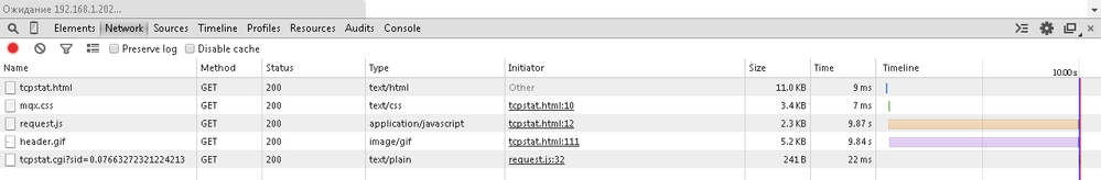

I am mot sure if I have exactly the same issue, but at least it's vey similar and related. I use MQX 4.1.1, build and start httpsrv example project for Vybrid, open the browser and go to http://192.168.1.202/tcpstat.html - so far so good. Then I hit refresh button and see something like this:
After some testing, I discovered this is the behavior with Google Chrome 38 and IE 11, but not with Firefox 31. Wireshark shows that indeed the browser's behavior is different. Namely, Chrome has a preconnect feature which opens connections and then FORGETS ABOUT THEM until it needs them or 10 seconds expire. Combined with the fact that RTCS seems to ACK all incoming connections (???) above and beyond the limit (tested with "_RTCS_socket_part_max = 2", same with "_RTCSPCB_max = 2"), but httpsrv may not have enough "params[i].max_ses = 1" configured to handle them all at the same time while Chrome may choose any... a pretty solid DoS attack.
I'd like the connections rejected if nothing can be done with them anyway or the situation solved some other way from RTCS side if at all possible. Alternatively, I might allow more sessions and hope that not many Chrome browsers attempt to bother my device at any given moment, but I would prefer to waste less RAM. Doing anything browser-side seems hopeless (the issue's years old).
P.S. Can anybody briefly explain me this "Open Connections" number, especially with relation to other numbers, and what resources, exactly, are consumed when it grows:
