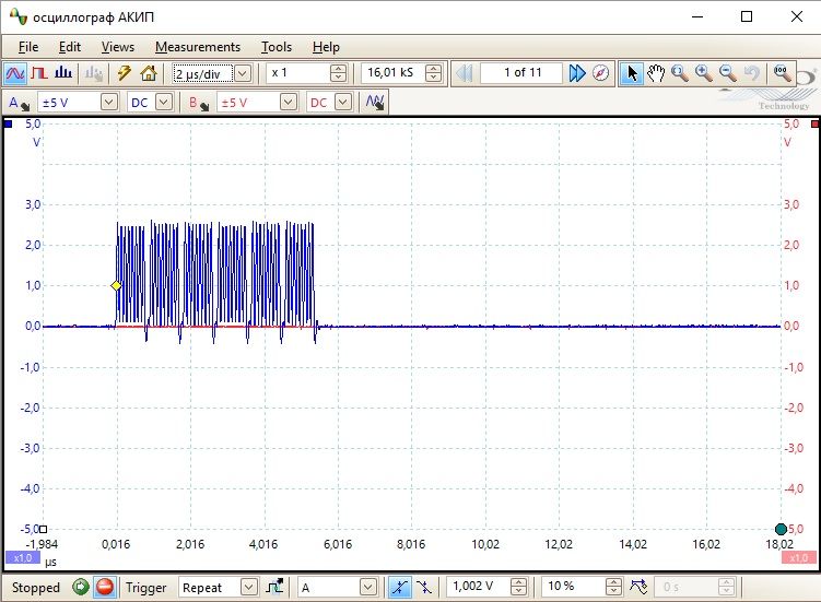

The problem is that Master MCU CLK works only for fwrite and doesn't work for fread.
It looks like:

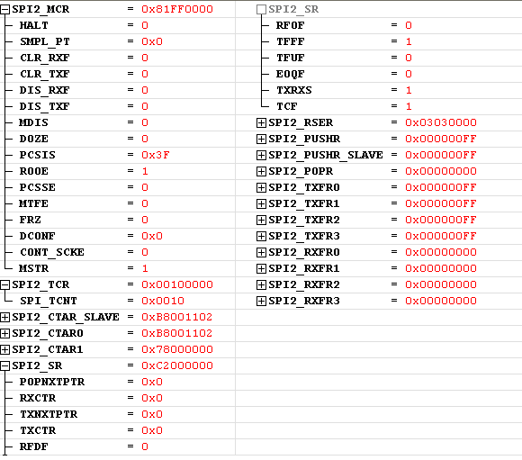

But in the SPI registers (SPI2_TCR) it's set that 16 bytes were transferred (6 for cmd and 10 for receiving data):
What can I do in order to solve this problem?

Recently I've found that it works without my oscilloscope connected.
But the strange thing is:
1. when I call fwrite it's possible to see CLK with oscilloscope
2. when I call fread it's possible to see CLK with oscilloscope
3. when I call fwrite and then fread it is not possible to see CLK with oscilloscope, but without oscilloscope connected it's working well
Perhaps this situation is fault of my oscilloscope (pico 72205A)?
