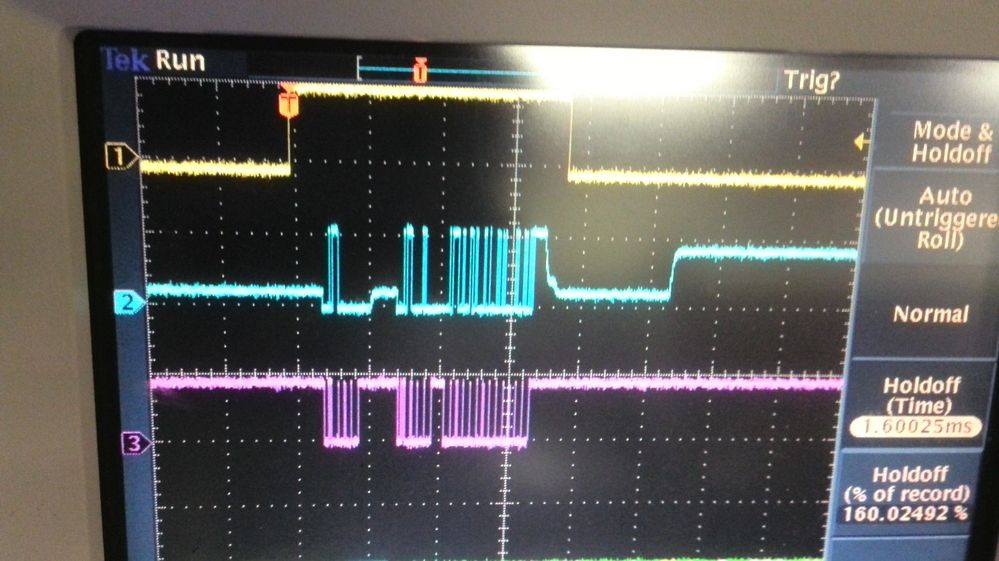

Seems like I have same problem for my SPI driver of MQX4.1.1. It is reproducible on my board with 1M bps baudrate , 8b frame size, big endian, clock mode 0.
Disabling DSPI_ATTR_USE_ISR seems to help. Another thing I noticed is that the transaction time measured from slave device IRQ assertion time is 100us shorter than the case with DSPI_ATTR_USE_ISR enabled.
In attached pictures, ch1 is IRQ asserted by slave device while ch2 and ch3 are MISO and MOSI respectively.  "read_good" shows a successful reading from device while the "bad_read" shows a failure of device reading.
