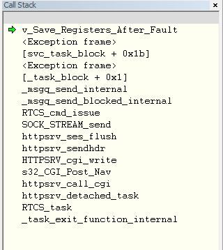

I have recently run into an issue when I call HTTPSRV_cgi_write. An unhandled exception occurs seemingly at _task_block.
Call Stack:
I basically followed what I found in the web_hvac example and my function that calls HTTPSRV_cgi_write (s32_CGI_Post_Nav) never gets to its return statement
Code snippet from s32_CGI_Post_Nav

I think the unhandled exception maybe related to memory issue, I suggest you check the st_Response.data buff, there is a reference code under the folder rtcs\examples\httpsrv.

I think i was going off the hvac example because the httpsrv has only GET examples and no POST ones. I also ran into the same kind of error with the HTTPSRV_ssi_write command. I was finally able to figure out that HTTPSRVCFG_TX_BUFFER_SIZE and HTTPSRVCFG_SES_BUFFER_SIZE were too small for what i was trying. I also get an error if HTTPSRVCFG_SES_BUFFER_SIZE is larger than HTTPSRVCFG_TX_BUFFER_SIZE  (if HTTPSRVCFG_SES_BUFFER_SIZE  is more full than HTTPSRVCFG_TX_BUFFER_SIZE  is big). Am I correct in my findings?

  HTTPSRVCFG_SES_BUFFER_SIZE is size of session buffer. Session buffer is used for buffering user data (CGI, SSI, files from file system etc.) for both sending and receiving.
  HTTPSRVCFG_TX_BUFFER_SIZE value is set with setsockopt function as OPT_TBSIZE for each session socket.
Generally speaking, HTTPSRVCFG_SES_BUFFER_SIZE should be less than HTTPSRVCFG_TX_BUFFER_SIZE
