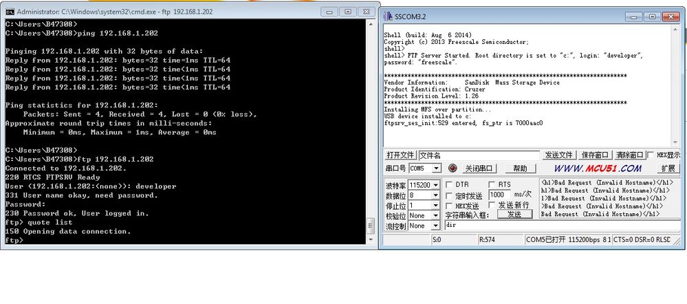

danielchen
I tried web_havc demo, enabled ftp server, pc as client. k70F120 as ftp server.  Here is my result. (I added a printf in ftpsrv_ses_init). Maybe you can refer to this demo1.jpg
