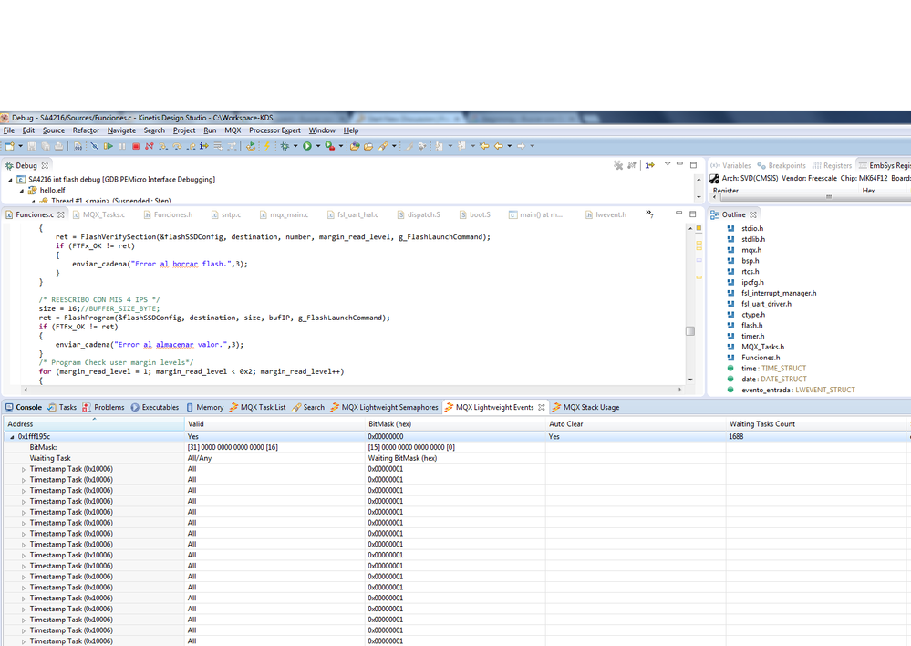

Hello I am using MQX 4.0 with KSDK 1.2.
Basically I have a task that is performing "_lwevent_wait_for(&evento_entrada, 0x1, TRUE, NULL);"
The event is created by the same task with "_lwevent_create(&evento_entrada,LWEVENT_AUTO_CLEAR);"
The event is being set by a GPIO in an interrupt with "_lwevent_set(&evento_entrada, 0x01);"
The problem is that at beginning the code works correctly, but later with a random number of interrupts by the GPIO, it start an infinite loop where the task is not being blocked when actually the event is not set.
Here I attach a screenshot where you can see the problem.
Thanks in advance,
Sebastian.

Hi Sebastian,
Two things come to mind.
1) make sure your task priorities are 8 and higher.  Lower priority numbers are reserved for the RTOS and I have seen where a user task at wrong priority can make the lwevent have issues.
2) Upgrade....KSDK_1.3 (http://www.freescale.com/ksdk) and see if this fixes issue.
David

Thanks David. I checked the task priorities and all was fine.
I discovered that the problem happen when I use the function "UART_DRV_SendDataBlocking(uint32_t instance, const uint8_t * txBuff, uint32_t txSize, uint32_t timeout)"
So I changed it with the non-blocking one.
Now I need to receive from UART in a blocking way and it seems to work corecctly but in a certain moment the task is being blocked waiting for the semaphore and the timeout don't unblock it.
I use "UART_DRV_ReceiveDataBlocking(uint32_t instance, uint8_t * rxBuff, uint32_t rxSize, uint32_t timeout)"
Did you ever hear of that?
Thanks!!
