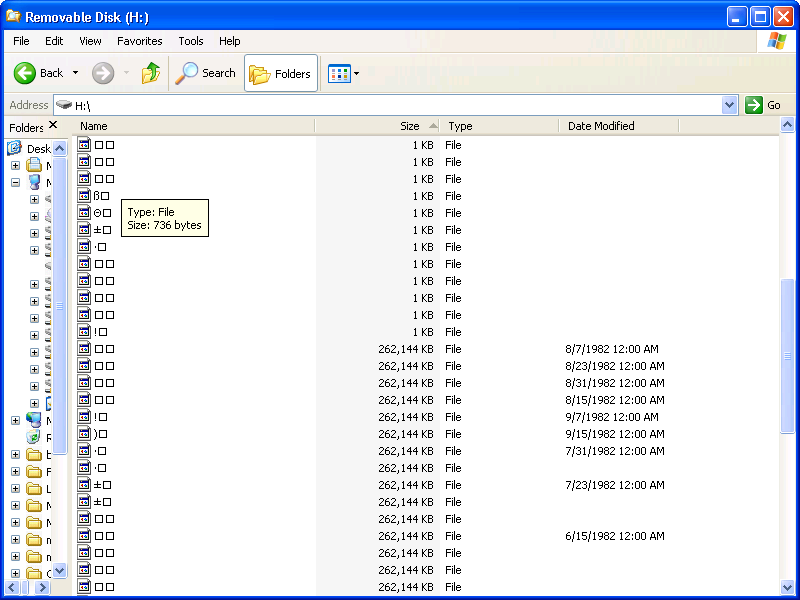

We had a unit returned that we believe was powered down when MFS was in an unsafe state. It ended up on my desk with a wiped boot sector, and I tried to design an experiment to replicate the problem, by cutting power to a unit, with MFS in various random states such as:files open, the middle of write, and in process of deletion (this one really jacks things up BTW). I was able to seriously mangle things up, and was surprised to find that Microsoft chkdsk.exe couldn't make things even partly right.
Then I remembered seeing a reference in MFS source that set  #define MFSCFG_NUM_OF_FATS 1, and reading some white papers on chkdsk.exe suggested that a single FAT table might cause prevent a chkdsk type program from fixing common errors as the secondary FAT provides backup and is relied on for certain errors (2 FAT tables are the standard).
Well adding #define MFSCFG_NUM_OF_FATS 2 in my User_Config.h file really made a mess of things.
Here is a screen shot of the directory structure after rebuilding MQX 3.8 with the new setting. Then my code calling
ioctl(fshandle, IO_IOCTL_DEFAULT_FORMAT,NULL);
followed by several hundred ioctl(fshandle, IO_IOCTL_CREATE_SUBDIR, (uint_32_ptr)dirName) and fwrite operations.
QUESTION TIME: IF I missed a step what do I need to do to make it all work nice?

Interestingly enough. I decided to rebuild one more time, redeploy, and retest, and this time it seemed to work fine. I am 100% convinced that rebuilding the PSP/ BSP was not out of sync as I did a complete clean and rebuild before deploying. . Could the fact that the SD Card had been formatted with a single FAT earlier, be contributing factor?
In either case I am not sure why it has decided to work. Clearly something didn't work right the first time, any Ideas where to start looking/ repeating the results?
2,867 Views
timias
I seem to have confirmed that the corruption happens, when formatting a disk where the previous format had been done using MFSCFG_NUM_OF_FATS 1 and you are now formatting MFSCFG_NUM_OF_FATS 2. But if you format it again, from the corrupted state to MFSCFG_NUM_OF_FATS 2 it works fine. UGH I thought I was going nuts. FYI the format command takes a really long time when it corrupts.
