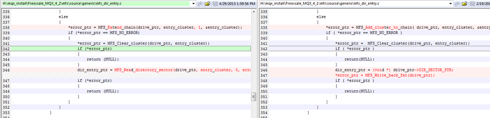

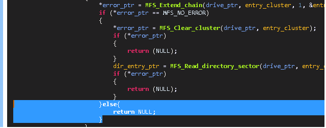

With out the following patch the call MFS_Extend_chain returning null is not handled, and if null (due to corrupted FAT) will causes hard faults.
diff --git a/mfs/Sources/generic/mfs_dir_entry.c b/mfs/Sources/generic/mfs_dir_entry.c
index fed539f..e715003 100644
--- a/mfs/Sources/generic/mfs_dir_entry.c
+++ b/mfs/Sources/generic/mfs_dir_entry.c
@@ -348,6 +348,8 @@
return (NULL);
+ }else{
+ return NULL;
Tags (3)

I do not find any difference in mfs_dir_entry.c between MQX 4.2.0 and patch MQX 4.2.0.2. Are you comparing the two versions?  I compared MQX 4.1 and 4.2,  they are different, but sees not your mentioned. How can I  reproduce your issue in my side. Thanks

Adding the highlighted section of code fixes the issue, otherwise an error returned from MFS_Extend_chain will cause a crash .

This has been fixed in MQX v5 and will be available in the next release.
