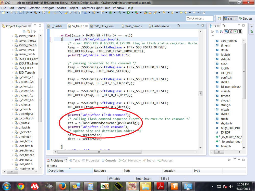

sudhakarp
Contributor V
hi,
i removed following function in my code but still i cant erase data. using FlashEraseSector() API.
flashSSDConfig.CallBack = (PCALLBACK)RelocateFunction((uint32_t)__ram_for_callback , CALLBACK_SIZE                                    , (uint32_t)callback);
actually my code was looping in this place, i dnt know why. i already put snapshot image also.
ret = pFlashCommandSequence(pSSDConfig);
           could you tell what exactly problem..? my new code i attached.

Jorge_Gonzalez
Hello sudhakar p:
The code looks OK. The root cause is very hard to determine without debugging, so if you could attach your project for me to recreate the problem it would be very helpful.
Some things I think you can check and debug:
- g_FlashLaunchCommand must be global and should point to a VALID address in RAM space after calling RelocateFunction().
- __ram_func must be global and defined as in the flash example: uint16_t __ram_func[LAUNCH_CMD_SIZE/2];
- Try disabling all interrupts before calling FlashEraseSector(). Something like this:
#include "fsl_interrupt_manager.h"...
INT_SYS_DisableIRQGlobal();
ret = FlashEraseSector(&flashSSDConfig, destination, size, g_FlashLaunchCommand);
INT_SYS_EnableIRQGlobal();
If I can think of more possible causes I will let you know.
Regards!
Jorge Gonzalez
4,264 Views
sudhakarp
Contributor V
hi jorge,
          thank you very very much. i am very happy now. actually interrupt only problem.
after disabling interrupt its working fine. you are great.. once again thanks for your support , and  thanks to

sudhakarp
Contributor V
Hi David,
     i find exactly where my code was hanging. i added image just see and give some solution.
Untitled.pnginside FlashEraseSector() API function one while loop there, here my code was looping.
so i debug through serial its outing only "Before flash command" its not outing "After flash command"
string. i searched that function definition but am not get anywhere. what that function will do. what is the use of that function if i comment that line
i can able to program internal flash only one time. after reset my board  am getting following error
---- HALTED DUE TO FLASH ERROR! ----
above error coming only my code size exceed 512kb (.bin) file size.
