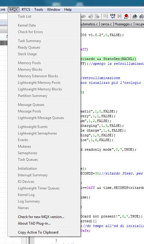

Migrating to MQX 3.7.0 I can still debug but all MQX and RTCS menus are dimmed.

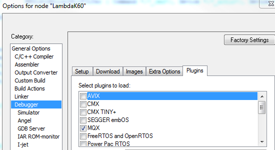

Hi Just in case this is of any use I am using IAR and MQX 3.8 and the TAD is working but when migrating from 3.6 to 3.7 perhaps the MQX setting have been turn off, so to turn them back on shown below

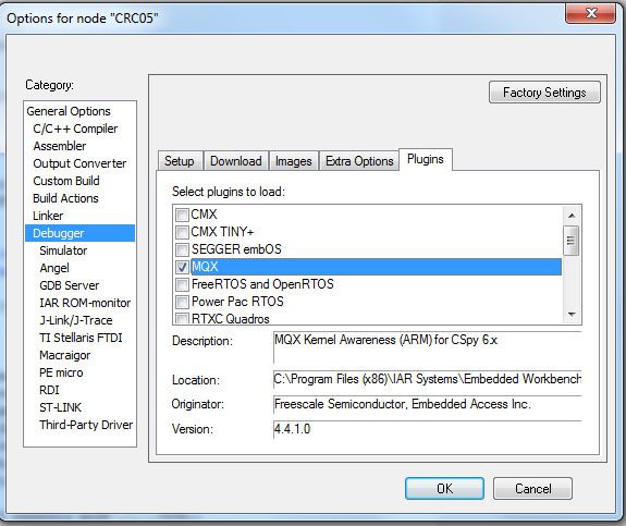

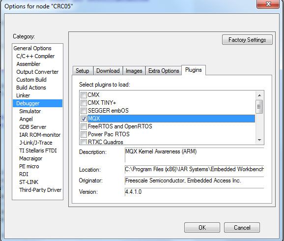

I tried both MQX 3.6 and MQX 3.7 plugins. I copy them form \Freescale MQX 3.X\tools\iar_extensions\Embedded Workbench 6.X\arm\plugins\rtos\mqx to C:\Program Files (x86)\IAR Systems\Embedded Workbench 6.0\arm\plugins\rtos\MQX,
This is for 3.6
and this for 3.7
As you can see description for 3.6 is "MQX Kernel Awareness (ARM)" and for 3.7 is "MQX Kernel Awareness (ARM) for CSpy 6.x".

If I work with MQX 3.7 I get the same problem both with 3.6 and 3.7 plugins:
Can you please tell me if you changed C:\Program Files (x86)\IAR Systems\Embedded Workbench 6.0\arm\plugins\rtos\MQX files or what you find in this folder?

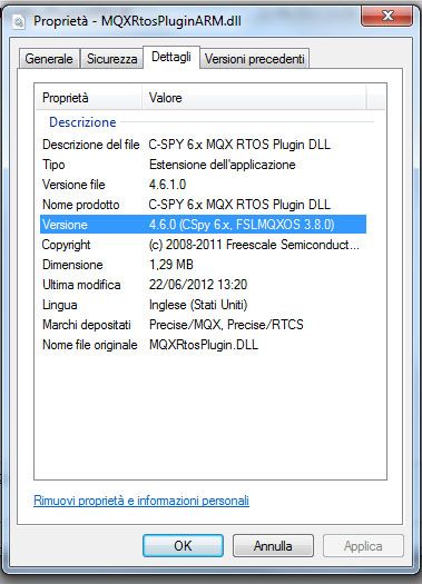

If I look at dll properties in \Freescale MQX 3.X\tools\iar_extensions\Embedded Workbench 6.X\arm\plugins\rtos\mqx file I get both for 3.6 and 3.7 this:
so FLSMQXOS 3.6.1.
Properties in \Freescale MQX 3.8\tools\iar_extensions\Embedded Workbench 6.X\arm\plugins\rtos\mqx are:
so FLSMQXOS 3.8.0.
FLSMQXOS 3.7.0 is not avaible from standard Freescale MQX installation packages.
