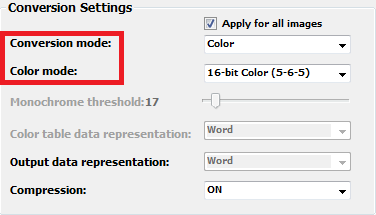

For the first question, the color mode code (in this case 0x8005 in the first example -lines 9 and 10-, 0x8000 in the second example, line 13) stands for the color mode used for the image conversion, in the Freescale Embedded GUI Converter Utility 3.0 this code are altered by the options "Conversion mode" and "Color mode":

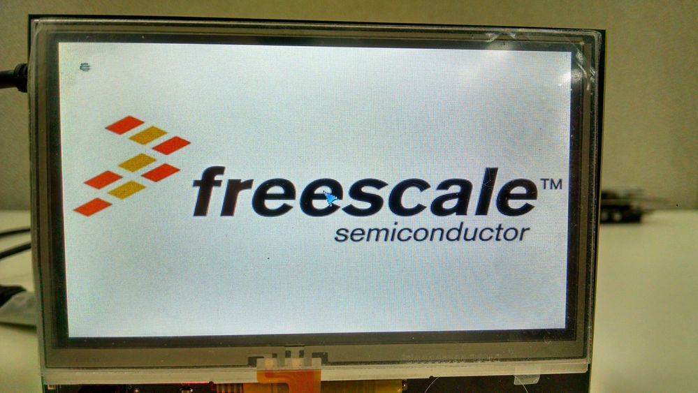

For the second question, the way you are trying to show the picture is correct, I just ran your code and everything is showing fine in the screen (I used another image because your array is not complete in this post). When you try to show the image what do you see in the screen? Is the program flow correct?
EDIT: I attached the source code I used to show the next image as background.
The only thing that has to be done to show this screen is to call this line code wherever you want.
  D4D_ActivateScreen(&screen_entry, D4D_TRUE);
And declare the screen in the same file where the screen is activated.
D4D_EXTERN_SCREEN(screen_test);
Earl.

          When showing the picture on the screen,I just see one rectangle with connected diagonal.
          For the background picture,a couple of days ago,I finally found that the 65K color mode macro definition was disabled,  as following code;
          // 65k colors bitmap without pallete
          #define D4D_BMP_65536NOPAL_ENABLE D4D_FALSE
          Then I enabled it,as following code,
          #define D4D_BMP_65536NOPAL_ENABLE D4D_TRUE
          now, it's work normally.
