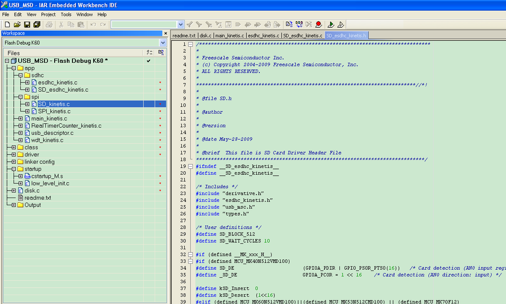

Kan_Li
Hi Pramod,
Actually there are two examples available for your reference, one is a mfs demo mounted on a sdcard, you may find it in "C:\Freescale\Freescale_MQX_4_1\mfs\examples\sdcard", and the other is a usb msd device demo for ramdisk, which can be found in "C:\Freescale\Freescale_MQX_4_1\usb\device\examples\msd". and if you looked into the USB stack ver 4.1.1, there is a ready bare matel project for that topic, which can be found in "C:\Freescale\Freescale USB Stack v4.1.1\Source\Device\app\msd\iar_ew\kinetis_60", you may find that demo provide SPI and ESDHC support for SD card, so maybe this demo would be more helpful to speed up your application design:smileyhappy:Please kindly refer to the following for more details.
Hope that helps,
B.R
