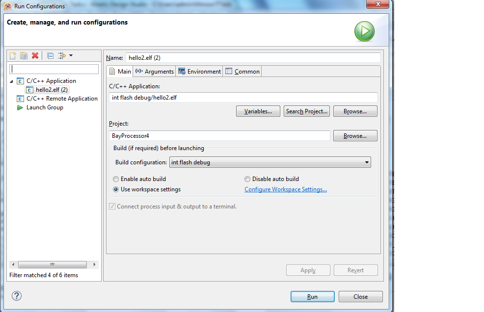

*I want to Run a Project instead of Debug. *
But problem is *I am not able to Run a Project *. Like right click project
-> Run. Debug works perfectly as in Debug Configuration there is a GDB
PEMicro Interface Debug available. But in Run Configuration I am not able
to found the same.
When I am trying to Run a project That show me an error (Attached with this
mail). Also I am attaching my project Run Configuration setting.
I dont know which kind of setting I need to do?
Please help.

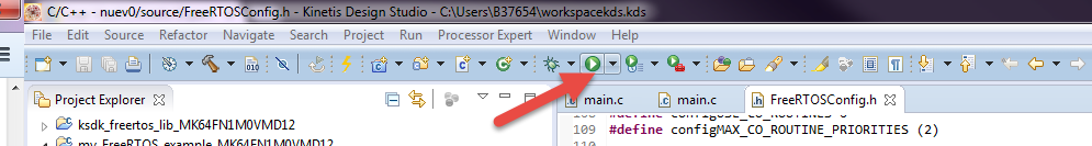

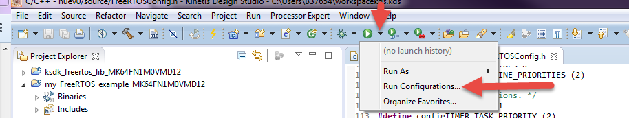

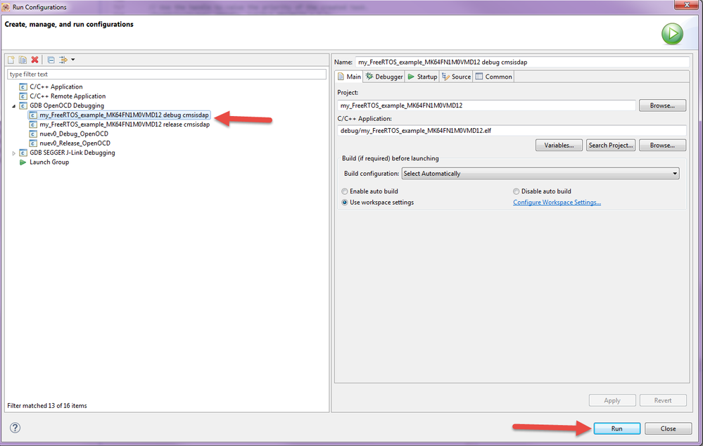

soledad
Hello Garima,
You can run a project using the Run button.
Select the Run Configurations...
Select the project and click on Run
Please let me know if this helps!!
Sol

As you suggest I go through Run Configuration but not able to find GDB OpenOCD Debugging.
I am attaching snap shot of My RunConfiguration... Can you tell me how to add this GDB OpenOCD Debugging in my RUN Config?
