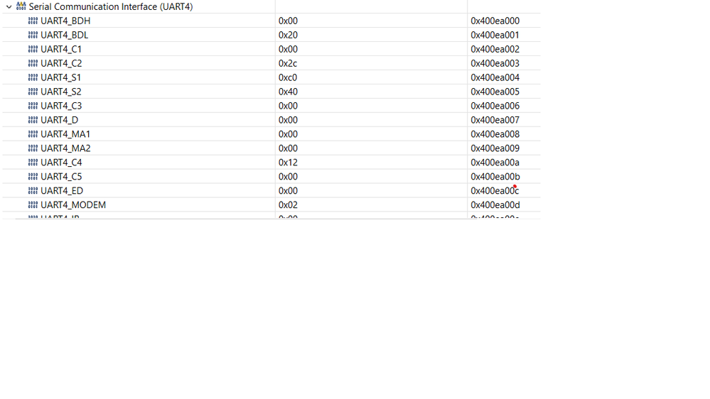

I am trying to modify what is supposed to be a debugged, functional application that runs on the K70 processor and uses MQX. I am using IAR's Embedded Workbench in debug mode.
After seeing it go off in the weeds consistently I tracked down the instruction that instigates this. It is an attempt to read the UART4 status register 1:
    s1Save = UART_S1_REG(channel);
The equivalent in the disassembly window is:
    LDRB R0, [R4,#0x4]
when I single-step in disassembly mode, it apparently triggers an exception handler, as the next address in the PC is 0x26DE2. Single-stepping in here pulls up an assembly source file: dispatch.S, containing these instructions:

I single-stepped down to the 'mrs r1, IPSR', just to see what gets loaded into r1, and the value is 3.
I am new to MQX, have mostly debugged Cortex M4 at the C level and am looking for clues what the long-gone prior developer has done to make UART4 unreachable. Have I uncovered anything relevant? What better approach is there to finding this?

 Uart 4 is not enabled in your user_config.h file,   uart4  is  BSPCFG_ENABLE_TTYE
#define BSPCFG_ENABLE_TTYE 0
#define BSPCFG_ENABLE_ITTYE 0
If you use interrupt mode uart , please enable it like:
#define BSPCFG_ENABLE_ITTYE 1
Please try it again.

danielchen
Please also check whether UART4 is enabled in user_config.h ?
If the uart clock is not enabled, the access for UART4 register will result in an hardfault.
