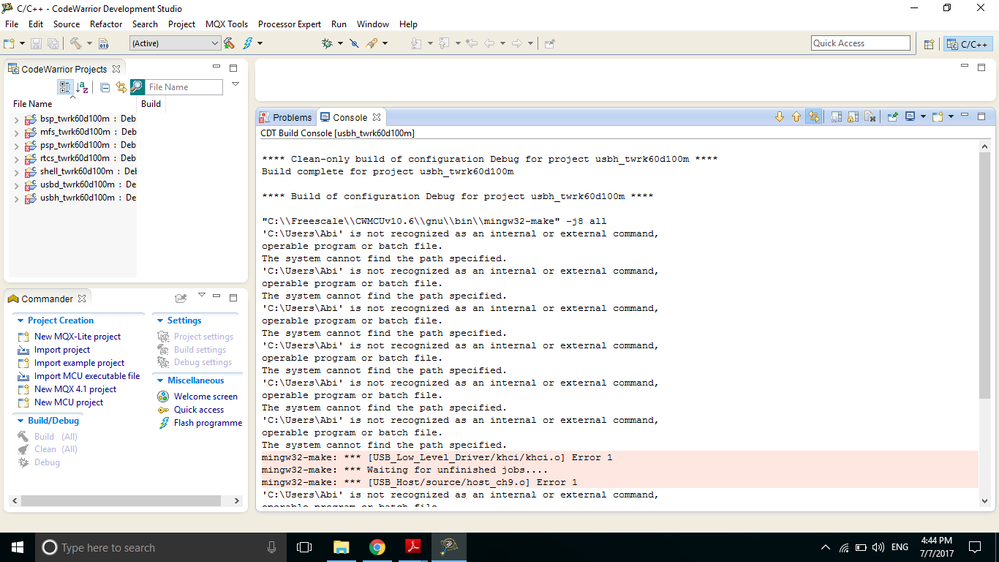

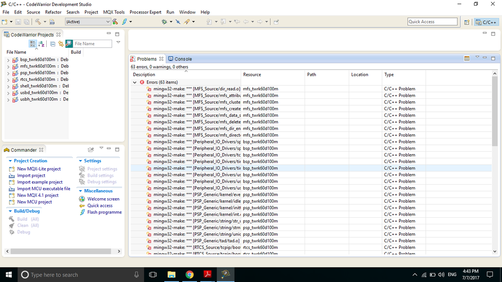

Hello, i have been trying to build the MQX 4.1 libraries for first time but i receive 63 errors i can do notpastedImage_1.png
Is there any step or something else i have to install o configure that i am missing?
Please if anyone can help me, Thank you.

these are the errors
Description Resource Path Location Type
mingw32-make: *** [Peripheral_IO_Drivers/usb/usb_mk21.o] Error 1
mingw32-make: *** Waiting for unfinished jobs....
mingw32-make: *** [Peripheral_IO_Drivers/usb/usb_install.o] Error 1
mingw32-make: *** [Peripheral_IO_Drivers/tchres/tchres.o] Error 1
mingw32-make: *** [Peripheral_IO_Drivers/timer/timer_qpit.o] Error 1
mingw32-make: *** [Peripheral_IO_Drivers/timer/timer_kinetis.o] Error 1
mingw32-make: *** [Peripheral_IO_Drivers/usb/usb_mk21_device.o] Error 1
mingw32-make: *** [Peripheral_IO_Drivers/spi/spi.o] Error 1
mingw32-make: *** [Peripheral_IO_Drivers/spi/spi_dspi.o] Error 1
