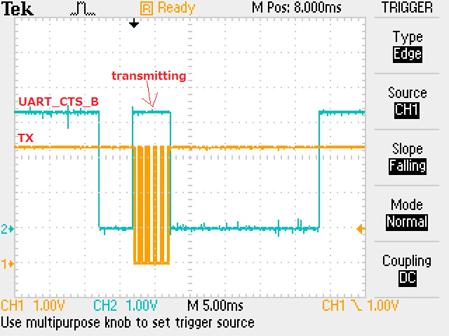

Hello community.
I have MX6DL custome board using rs485 half duplex, currently using 4.1.15 kernel.
I have seen the file imx.c in drivers / tty / serial / imx.c but it seems to not support rs485.
My question is how to add support rs485 mode half duplex?
Thanks in advance

   About I.MX6 UART to RS485 applications, I have some advice for you .
1. Using RS485 mode of UART directly.
On hardware, you should use UART_CTS_B to control RX & TX.
On software, The link for you reference:
Does UART in RS485 mode support only 9 Bit mode for i.MX6 ?
2. Sensing IO direction Automatically via hardware, don't need to tune software.

Hi  Wigros Sun
Thank you for answer.
I tried use UART_CTS_B to control RX & TX witch below setting:
/* enable RS485 mode: */
rs485conf.flags |= SER_RS485_ENABLED;
/* set logical level for RTS pin equal to 1 when sending: */
rs485conf.flags |= SER_RS485_RTS_ON_SEND;
UART_CTS_B pin has gone to high level when transmitting but after transmission is completed, it will not return to low level. In the default ,UART_CTS_B pin is high. This is the transmission waveform
How to change the default of UART_CTS_B pin to a low level to receive signals at any time?
