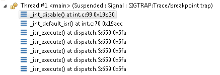

I've got a project that (seemingly) all of a sudden stopped working.  I'm down to the point where the main object of interest has now been stripped of everything.  No inheritance, no members to initialize, pretty much a blank class with some empty methods.
When I run, I try to step into the constructor for the class and KDS just hangs.  When I click the pause button to figure out what's running, this is what I see:
As luck would have it, as I was running my code again to get the above screenshot, I was able to get some task information as well, which I previously hadn't been able to get:
MQX_UNHANDLED_INTERRUPT (0x0041) is pretty specific.  I'll start looking for that code.  If anyone knows what it is, please post it!  :smileyhappy:
Back to my original question, is the right process to follow:
  1. install hardfault, memory, etc. interrupt handlers (I have the four main ones)
  2. pause anytime your code execution seems stalled
  3. install the MQX task-aware debugging tools
  4. single step through the "frozen" code until you get task info, like I was fortunately able to get this time around?

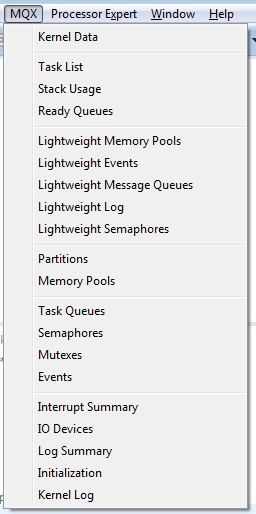

I have not, but will try the next time around.  Can you point me to a document that explains everything that's available in the MQX menu?
3,725 Views
danielchen
Hi Dave:
There are several documents about MQX with CW, please check the following folder.
C:\Freescale\Freescale_MQX_4_2\doc\tools\cw\
