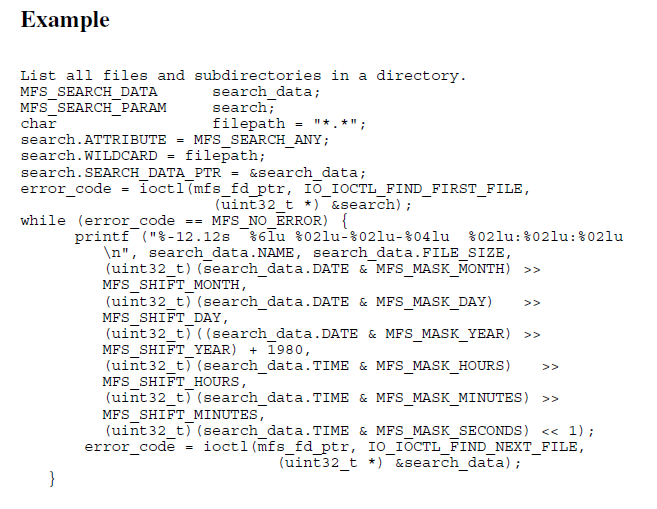

I am running MQX4.2 and have built USB and MFS into my project.   A USB drive is interfaced OK and MFS installed.   I can read using 'read' a file so I am confident MFS is OK.   Is there a short way of reading the count of files in the present directory?

I would suggest you try IO_IOCTL_FIND_FIRST_FILE,IO_IOCTL_FIND_NEXT_FILE commands to search on the disk.  There is an example to list all files and sub directories in a directory. You can count the files in a specified directory.
Please refer to the MQX_MFS_User_Guide.pdf, section 3.8.1.8 for more details.

Thanks.  That's what I did in the end.   I was hoping there was a simple command as this is rather long winded just to get a file count.  Works though

I agree with you it is long, but MFS does not provide a simple command as your expected.
