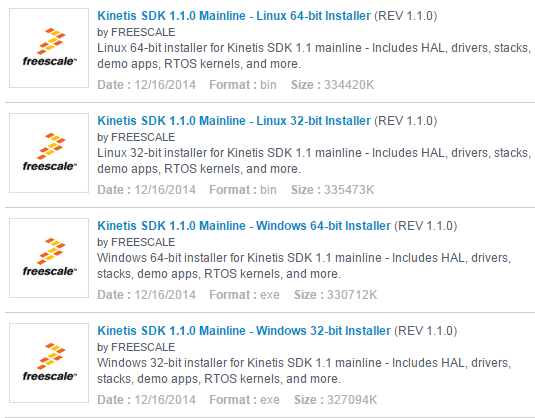

1. Download Kinetis SDK v1.1.0 with MQX RTOS at www.freescale.com/ksdk
Click Download.
Choose the appropriate Kinetis SDK v1.1.0 installer for your operating system, then download and install it.

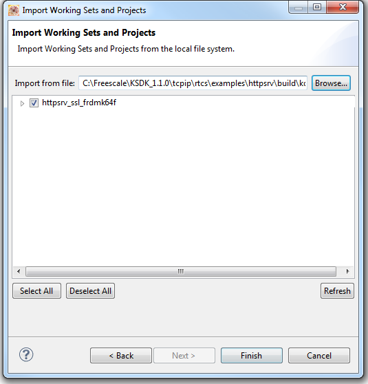

5. First Import the httpsrv_ssl_frdmk64f working set. This includes all the libraries that need to be built.
Browse <Kinetis SDK>\tcpip\rtcs\examples\httpsrv\build\kds\httpsrv_ssl_frdmk64f

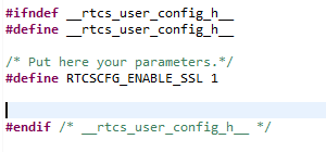

7. Configure RTCS to use CyaSSL.  Open the rtcs_frdmk64f project.  Expand the RTCS_Include group.
Open rtcs_user_config.h file and add  #define RTCSCFG_ENABLE_SSL    1

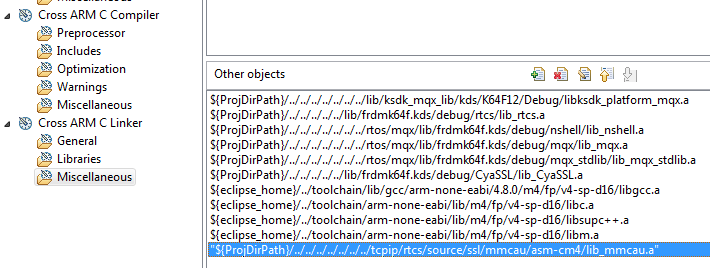

11.   Now add the path to the mmcau library in the application project linker settings.
Right click on the httpsrv_ssl_frdmk64f project and choose Properties
Open C/C++ Build and choose Settings.  Under Cross ARM C Linker…Miscellaneous…Other objects add ${ProjDirPath}/../../../../../../../tcpip/rtcs/source/ssl/mmcau/asm-cm4/lib_mmcau.a (or the alternative path you placed the folder).

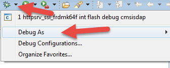

14. Select the httpsrv_ssl_frdmk64f project, and click on the arrow next to the image of the Bug and select Debug Configurations
15. Choose the debug connection programmed in your board’s debug firmware.  (Default for FRDM-K64F is cmsis-dap)

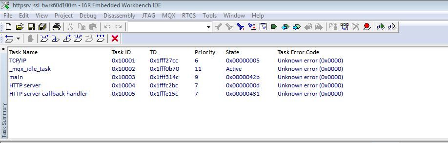

I followd above steps for sample example "httpsrv_ssl_twrk60d100m" for "twrk60d100m" tower board using IAR workbench (version 7.10.3.6932).
It shows the sample web pages in browser using HTTPS. But after some time web server crashes/hangs.Some times the web server will not even start(doesn't show the web pages) on flashing the code to tower board.
I see below Task Errors in IAR Task Summary.
Please let me know how to fix this issue.

We know about issue in CyaSSL implementation in KSDK1.1.0.
Problem is in handling error results from SSL library. In these cases RTCS didn't deallocate resources (memory, sockets,..).
This will be fixed in KSDK1.2.0 (release should be available during end of April 2015).
