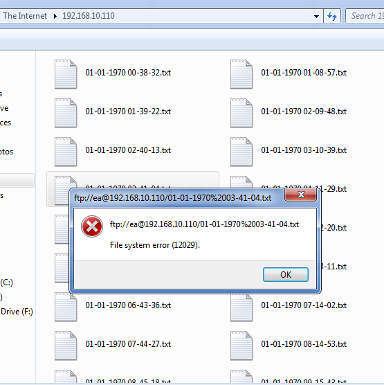

Hello Community,
In my project I run a ftp server on a sdcard file system. I use TWR-K60f120 and MQX 4.1. Mostly, I used code in web_hvac demo to run the FTP and Telnet server (attached rtcs.c)
I use a few different ftp clients such as Filezilla, Internet explorer and Windows explorer . Once I connect I could see the list of the files on the sd card. The problem is that I can not open them or transfer them to my local PC.
this image shows the error message once I try to open a text file.

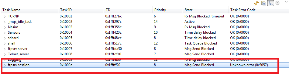

In the task debugger I get the following error (unknown error 0x3057)
All rtcs setting are in default values.
I used to work with MQX 4.0 and I never had these issues! Any suggestion? idea?

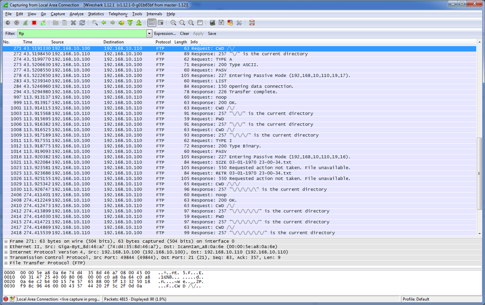

troide
I wireshark the ftp transaction and as you can see in the snapshot below every time clinet request CWD, the server adds a fake subdirectorty with the same name to the original directory address. That's why it can not find the files.
is there anyway to handle this problem?
3,238 Views
troide
As I mentioned in the last post there is a bug with CWD command. I modified ftpsrv_cwd(FTPSRV_SESSION_STRUCT* session) in ftpsrv_cmd.c

I'm not sure if this is the same problem I have just had. It appears some FTP tools pass / in the file paths but the MFS file systems can't cope, especially when it ends up with something like "a:\/newFile".
I have added a loop to replace all / with \ and that seems to fix the problem for me:
