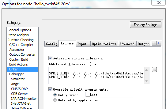

Hello:
Now doing a project, is through the TFTP to download the application.
I am using FNET bootloader that support the TFTP download this open source project.
The development environment is IAR7.2 TWR - K64F120M development board.
I do the test with the two applications, including the “hello_world” KSDK has been successfully downloaded to a flash and can run normally, in serial print “Hello World”!But with “hello” MQX system engineering can't run normally.According to https://community.freescale.com/message/332455#332455 this article finished the relevant configuration.
I revised the icf file:

In user_config. H file to add definition:
# define MQX_ROM_VECTORS 0
Recompile the MQX lib project.To recompile the hello project (application).
Modify the IAR default program entrance
Sent via download after the bootloader "go" command, can't jump into application execution.Test and operation in the "go" command made a breakpoint, without MQX system (KSDK) engineering directly run directly after the "go" command.Take MQX system engineering "go" The order came after a warning:
Fri May 15, 2015 15:05:54: The stack pointer for The stack 'CSTACK (currently 0 x1fff0900) is outside The stack range (0 x2002f000 to 0 x20030000) and then stop running.
Is beyond the scope stack.Whether icf file not configured, because is k60 articles.what I use is k64!
Need your help, Thanks in advance.
1,358 Views
lechangnian
Has been solved,define MQX_ROM_VECTORS To recompile BSP and PSP libraries.
