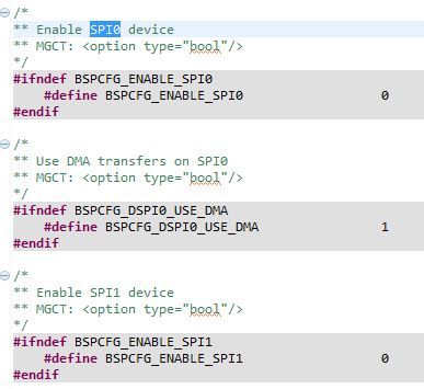

I appreciate the help, but unfortunately I can still not get it to work.  I disabled the SPI0 and SPI1 connections in both the user_config.c and twrk60f120.m.h files and left SPI2 to 1.   Should I be leaving any of the SPI0/SPI1 options in the twrk60f120m.h file set to 1, or should they be 0? An image below shows where I changed them.  Also my int_gpio.c has a warning of pctl may be used uninitalized in this function.  The error is shown below.
