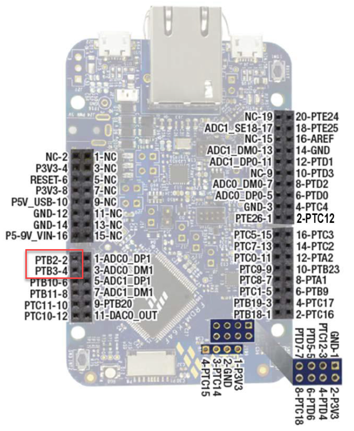

amal_jose
 Hinxf58474 ,
    Thanks, It is possible, but I wanted to know that, is it possible to configure both ADC0(PTB2,PTB3) and ADC1(PTB10,PTB11) channels using the same method ? doubts regarding Different trigger source for DMA1 and TCD configuration,

Hi [email protected],
As you might know, the structure of the example proposed is that one DMA channel is in charge of transfer from ADC register to memory buffer, and the other channel is in charge of modify the ADC channel configuration (from memory g_ADC_mux to ADC_SC1 peripheral register). With this structure, you can add more channels, with the FRDM up to 4 channels.
This is the purpose of the original example, to be able to multiplex between different channels of the same ADC.
ADC0 Channel 12
PTB2
ADC0 Channel 13
PTB3
ADC0 Channel 14
PTC0
ADC0 Channel 15
PTC1

nxf58474
With the code from the document, you can change the mux of ADC0 Channels. If you make a small change in the code, you can add the Channel 13, and modify the g_ADC_mux array.
With this, you have the Channel 12 in PTB2 and the Channel 13 in PTB3, both Channels of ADC0.
Hope this helps. If you have any question please let me know.
