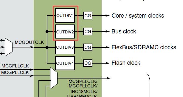

Hi everyone,
I'm trying to use DMA for UART2 on TWR - K65F 180M. The reason is UART2 is readily available through the USB and easy to test.
I came across this example application low_power_dma_uart_demo, which tried to add the DMA to LPUART0. I did not test it as LPUART0 is not readily available on any connectors.
But I tried to make some changes to adapt the code to UART2. Below is my code.

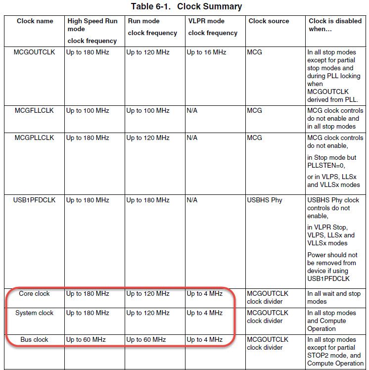

When I run this code, I could just see the first byte on the terminal (In this case just 'A'). As you can see I'm trying to send 26 bytes through UART. After running the code I can see SADDR actually offset by 26 bytes which indicates that the DMA has transferred all 26 bytes but the UART is not fast enough to capture and send all 26 bytes. This could be because both DMA and UART are configured with different clock source (DMA-System Clock; UART2-Bus Clock).
The low_power_dma_uart_demo example confirms this with the following comment.
    // Switch the system clock to the IR Clock !!!
    // NOTE:  Due to a rev 1.0 errata, the UART and DMA must be clocked from
    // sources that are approximately the same frequency.  Otherwise, the
    // DMA will finish before it is time.
In which they try to use the IR clock to configure LPUART.
My question is how do I configure UART2 and DMA to use a clock source of same frequency? Could you please give me an example?

jeremyzhou
Hi Vivek,
Thank you very much for your focus on Freescale Kinetis product. I'm glad to provide service for you.
According to the reference manual, you can see that the maximal frequency of the Core clock and Bus clock is different, one is 180 MHz, however another is 60 MHz(Fig 1)。
So if you want to get the same frequency of the both clock sources, I'd like to suggest that you have to follow through these procdures.
1. Make sure the frequency of the MCGOUTCLK <=60 MHz;2. The OUTDIV1 and OUTDIV2 should be same(Fig 2);
                                                                              Fig 1
                                                                                Fig 2
Hope it helps.
