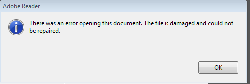

MWMinor
Contributor V
Hi Sol
Many thanks for the reply, but I'm having trouble downloading the link to the pdf.
This is the message I get..
Could you please check the file is still accessible...??
Thanks for your support
