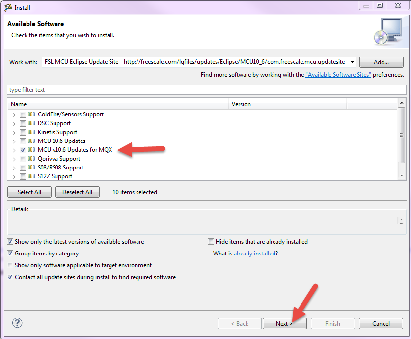

I have recently upgraded from 4.1 to MQX 4.2 and I am still using CodeWarrior for MCU
Version: 10.6
When I try to create a project the option from the drop down shows MQX 4.1 and the Select Board
Dialog box is empty. It would appear that CodeWarrior is still pointing to the old 4.1 folder. Where
is this option located and how do I setup CodeWarrior to use MQX 4.2 folder and options?

Hello David
Please follow the below steps:

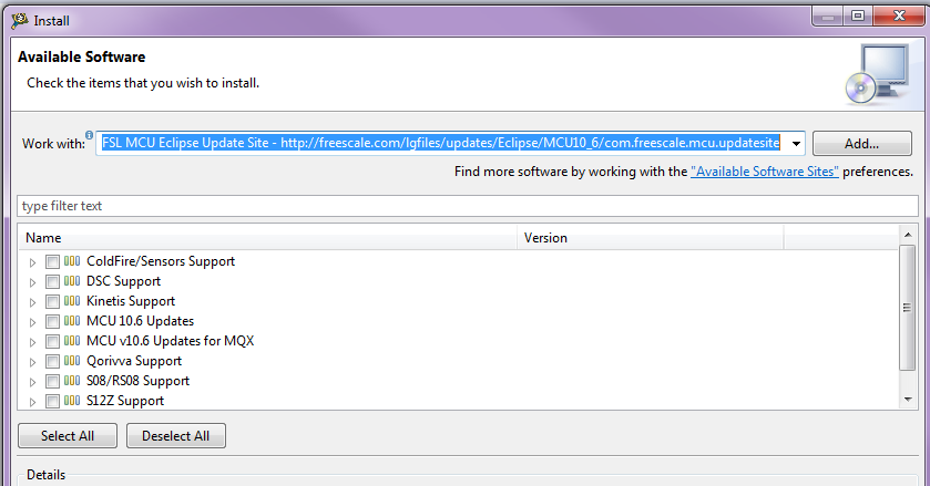

1. Go to Help->Install New Software
2. In the work with space select  FSL MCU Eclipse Update Site - http://freescale.com/lgfiles/updates/Eclipse/MCU10_6/com.freescale.mcu.updatesite
3. Select MCU v10.6 Updates for MQX and click next  (follow the steps to complete the operation)
4. After install the plug-ins, restart CodeWarrior. At this point you should be able to create a new MQX project.
