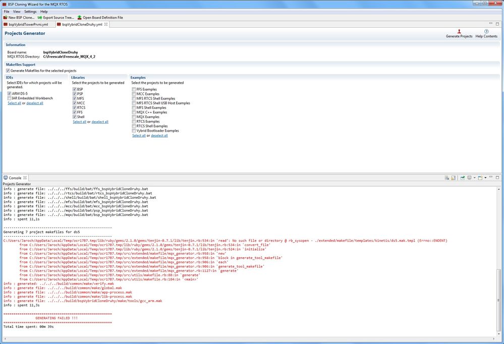

I have used BSPCloningWizard to generate project files including makefiles. Process ends up with following error:
I have Win7 64bit and 32bit, MQX4.2, Vybrid twr A5. If I do the same thing with MQX4.1 everything was OK.
Do you can advice how to remove this error?

Hello Jaroslav,
I reproduced the issue and I will report this to our development team. meanwhile please try with following:
1. copy the  ds5.mak.tmpl file located at the path C:\Freescale\Freescale_MQX_4_2\tools\generator_ruby\records\extended\makefile\templates\kinetis
2. paste this file into following path: C:\Freescale\Freescale_MQX_4_2\tools\generator_ruby\records\extended\makefile\templates\vybrid
3. using the BSPCloning wizard,  generate again  the makefiles for DS-5.
